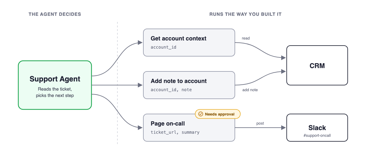

Take a support agent handling the inbound queue. It has three workflows as tools:
  • Get account context. Pulls the account from the CRM, checks contract status, scores health. It works, and it's boring, which is the highest compliment you can pay a workflow.
  • Add a note to the account. Takes an account ID and a note, and writes the note. That's all it can do.
  • Page on-call. Posts an urgent ticket to the on-call channel.
The agent reads each ticket, decides whether it needs account context, drafts a reply, logs what happened, and escalates anything urgent. It decides when each workflow runs. What happens when a workflow runs is fixed, step by step, the way you built it.
That second workflow is the one to notice. Without a workflow in between, logging a note would mean giving the agent write access to your CRM and trusting its instructions to keep it to the notes field. With the workflow, the agent never holds that credential. It holds a workflow that adds a note and does nothing else.
Example of an agent calling workflows

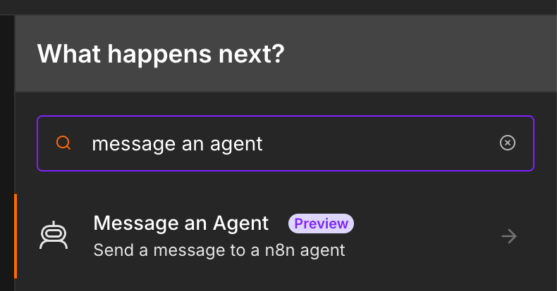

Agents work in the other direction too. When a workflow needs an agent for one of its steps, add the Message an Agent node. It sends the agent a message built from your workflow data and passes the agent's answer to the next node.
The agent brings its own instructions, tools and memory, so the node itself stays simple: you define what goes in, and you get the answer back. It's the same published agent your team uses everywhere else, so when you update the agent, every workflow that calls it gets the update.
The AI Agent node is still there and works as it always has. Use whichever fits the job.
