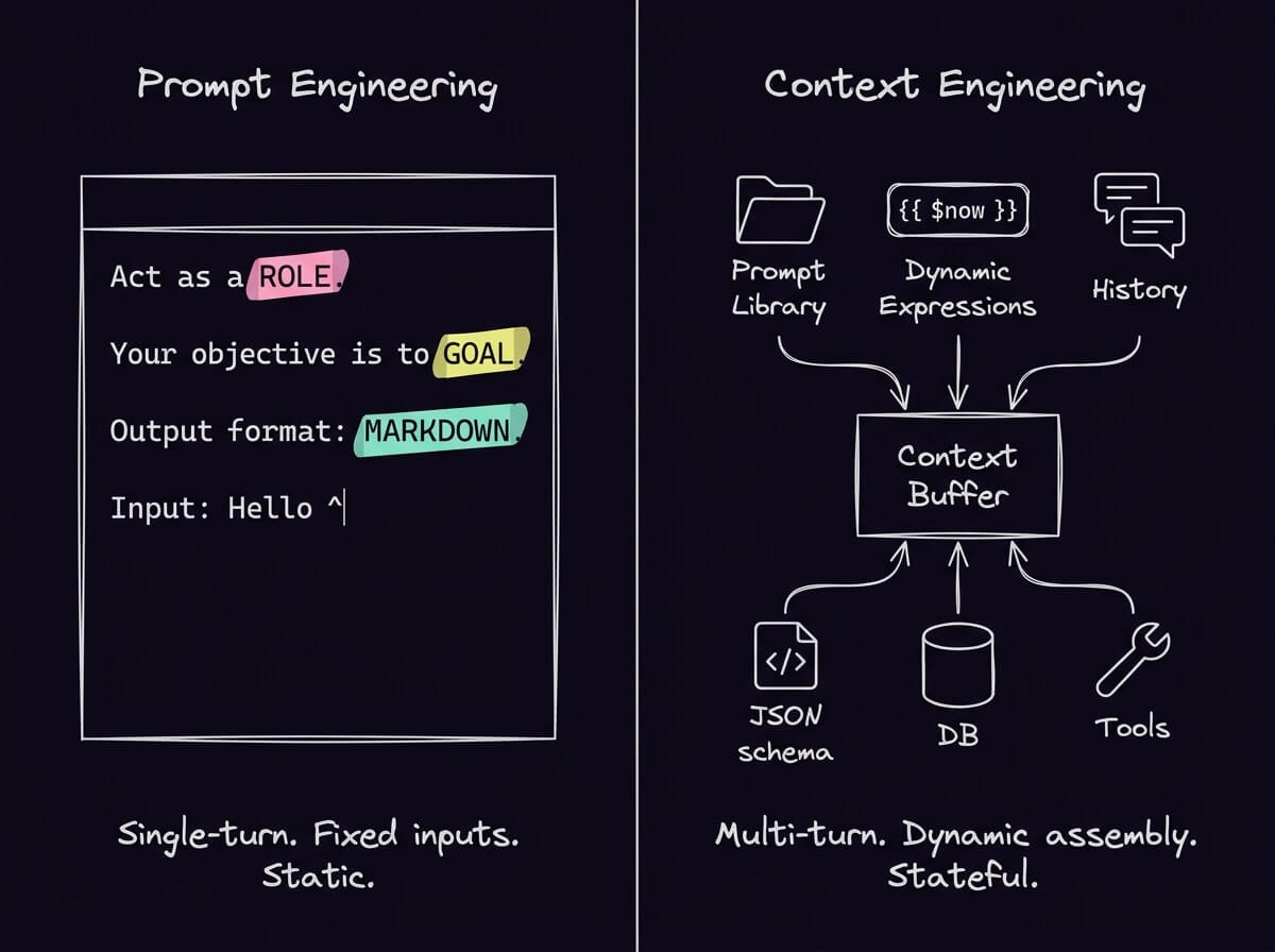

  • Context engineering is a software engineering discipline. It treats the LLM context window as a dynamic data buffer. Instead of manually tweaking prompts, engineers design automated systems to programmatically assemble and filter data during each model call. Context engineering also involves compressing and clearing historical interactions, retrieved knowledge, and tool schemas across multi-turn conversations.
Diagram contrasting static prompt engineering with dynamic context engineering, which assembles a context buffer from prompt library, history, DB, and tools.
Prompt engineering shapes a static prompt; context engineering dynamically assembles the whole context window at every turn
Prompt engineering and context engineering aren't competing approaches. The system prompt is one component of the context window, alongside conversation history, current request, retrieved documents, tool descriptions, and tool results. In production, the system prompt is often a small fraction of what the model sees. The rest — including memory, RAG results, and tool outputs — is what context engineering manages.

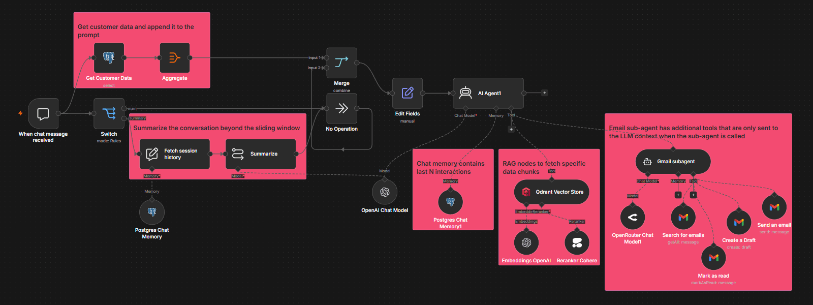

n8n changes this by exposing the full context lifecycle as configurable, inspectable nodes. Instead of relying on rigid abstractions, you get direct, granular control over your memory backends, context window thresholds, retrieval timing, and tool-call scopes.
You can implement each context strategy covered above with specific workflow components. IF/Switch nodes handle dynamic context selection, routing queries to different retrieval paths based on intent or user type. The Code node or Basic LLM Chain let you compress data, summarizing history or extracting structured facts before they enter the context window.
Sub-workflows are good for isolation, where each sub-agent operates in its own context with only the tools and data it needs. Memory sub-nodes take care of history management, controlling how many turns persist and where they're stored. Every decision about what enters the context window is a node on the canvas, not a line buried in code.
n8n workflow showing context engineering: switch-based routing, conversation summarization, persistent memory, Qdrant RAG retrieval, and an isolated Gmail sub-agent.
Context engineering in n8n: switch-based routing, conversation summarization, persistent memory, Qdrant RAG retrieval, and an isolated sub-agent whose tools only enter context when called
Because n8n is built around visual workflow orchestration, you can inspect, debug, and modify context flows at every step of execution. If an agent fails, you don't have to guess what went wrong. You can open the execution history and view agent logs, look at the exact JSON payload sent to the LLM at that inference step, see the input data, what the model returned, and adjust the workflow logic directly.
This provider-agnostic architecture also means your context engineering patterns aren't locked into a single model vendor. The same memory sub-nodes, retrieval flows, and tool isolation patterns work seamlessly whether you're using OpenAI, Anthropic, or self-hosted models. As the AI ecosystem evolves, you can swap models or update memory configurations or add new tools without rebuilding your entire orchestration layer.
