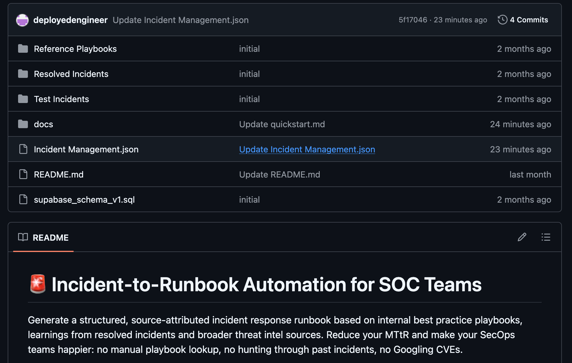

- Set up the workflow found on Github on your own n8n environment.

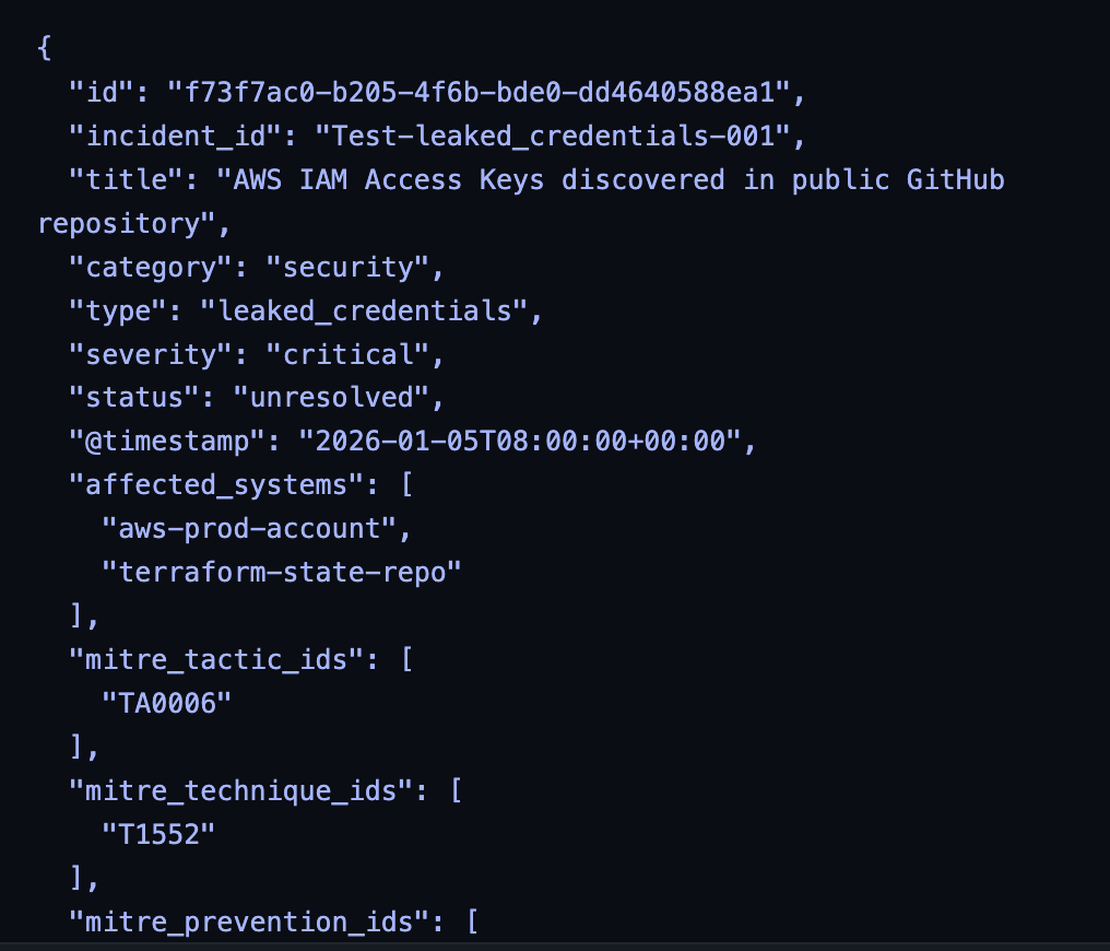

The workflow receives a JSON payload at a webhook address created in n8n. This format is typical of an incident or ticket from your SIEM (e.g. Elastic) or ticketing tool (e.g. Jira).

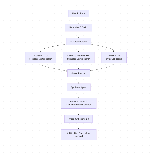

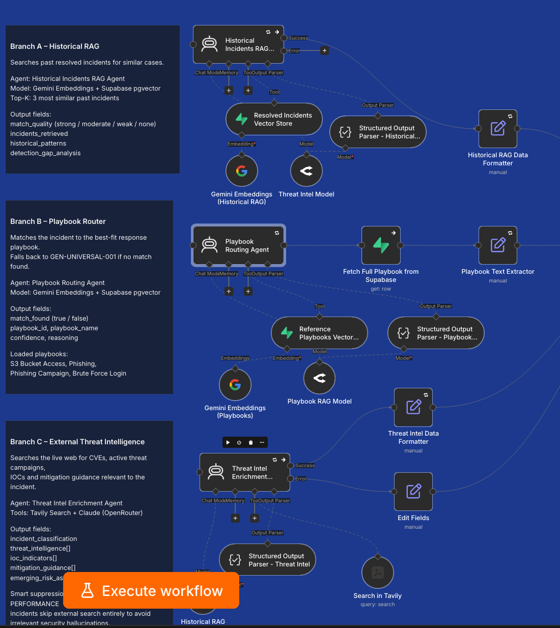

The payload is ingested and triggers three parallel retrievals: the closest matching reference playbook, similar resolved incidents from your historical record, and current threat intelligence from the web.
A synthesis agent combines all three and produces a structured runbook: immediate actions, containment steps, IOCs, assumptions stated explicitly, confidence levels where certainty is low.
The principle is reuse, not re-invention, each time and resolve repeated incidents faster. You're asking the LLM to organize what your team already knows, not to generate a response plan from general training data.
Underpinning this is a RAG pipeline, also built using n8n that chunks your playbooks and past incidents and stores them in a Supabase vector database ready for the main work flow. Instructions are provided to continuously integrate new resolved tickets or playbooks into this vector database.
Architecture walk-through
Let’s look at each of the retrieval lanes more closely:
  1. Playbook retrieval. Reference playbooks are chunked and stored in Supabase. A new incident runs semantic similarity search against the playbook library. Top match retrieved. If match quality is low, that gets flagged — the agent doesn’t silently proceed as if it found a strong match.
  2. Threat intel enrichment. For demo purposes this is a web search via Tavily based on the alert type, associated TTPs, recent advisories. In production, you would plug in your production TIP or a combination of threat intel tools.

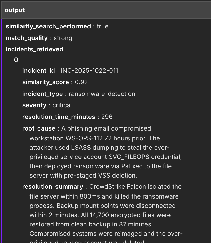

Historical incident retrieval. Resolved incidents go through the same vector pipeline. Same database, different table. Similarity search pulls the most relevant past cases with full context: what happened, how it was contained, what worked, what took longer than expected.
Results from all three lanes merge into a single synthesis agent. The synthesis agent takes that block plus the original incident data and produces the runbook.

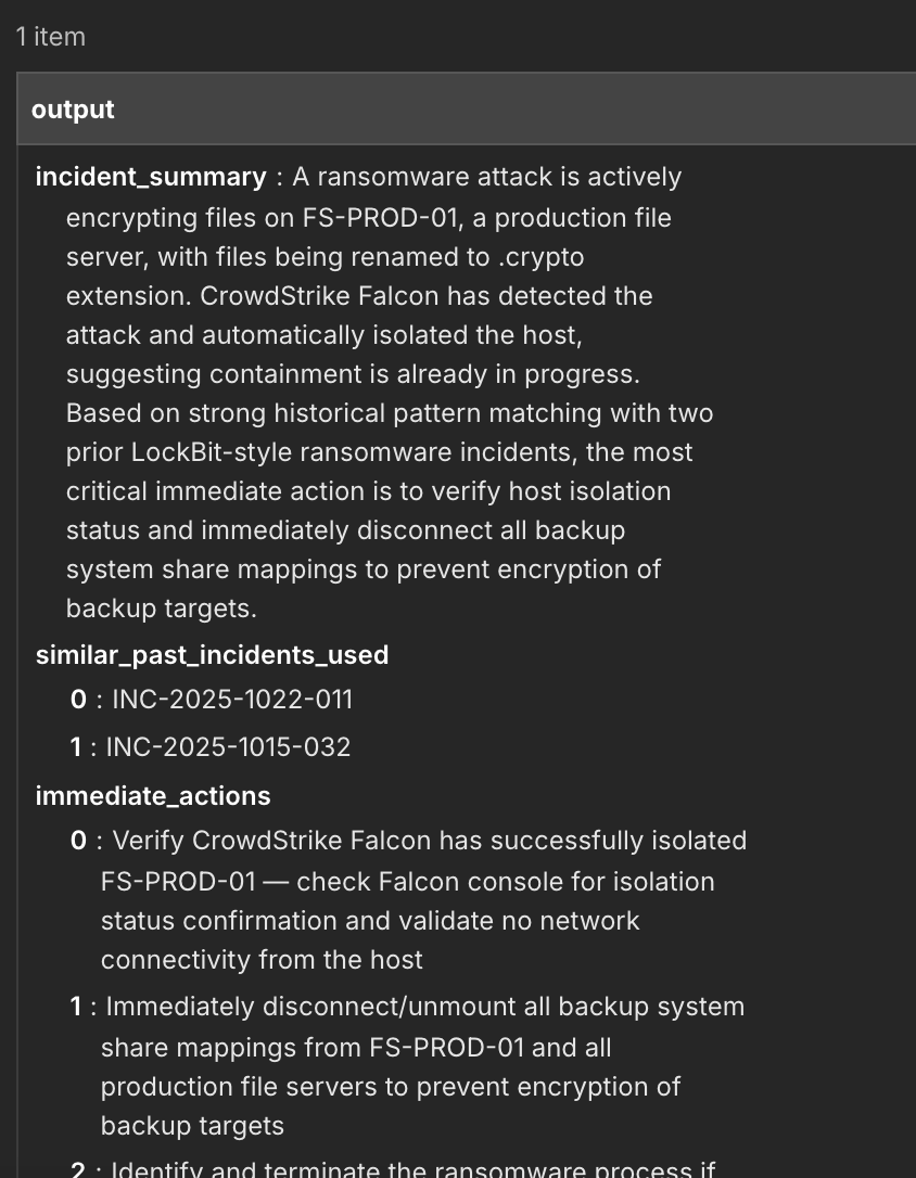

  1. Structured JSON — a validated schema with discrete fields: incident summary, immediate actions, containment guidance, extracted IOCs, assumptions and confidence levels. Each field is addressable downstream. Pipe it into a ticketing system to pre-populate fields, feed it to a SIEM rule, or trigger a downstream n8n workflow without parsing free text.
  2. Markdown runbook — the same content as a formatted document. This is what posts to Slack, what goes into a war room doc, what a human reads during the incident. Source labels are inline so attribution is visible without opening the JSON.
Both come from the same synthesis run. The JSON is the authoritative output; the markdown is generated from it. If you only need the human-readable version, ignore the JSON. If you're building an integration, parse the structured fields and ignore the markdown.

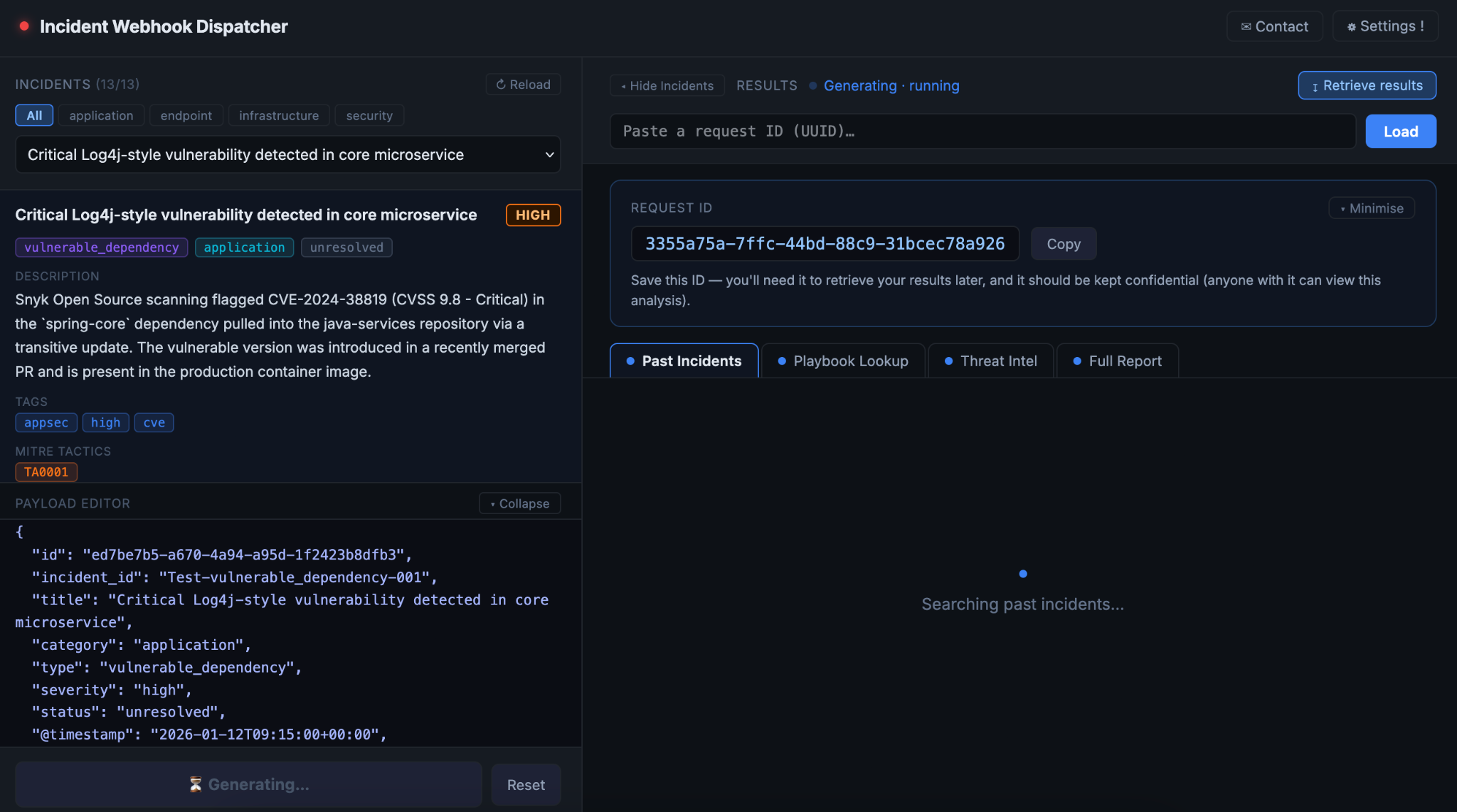

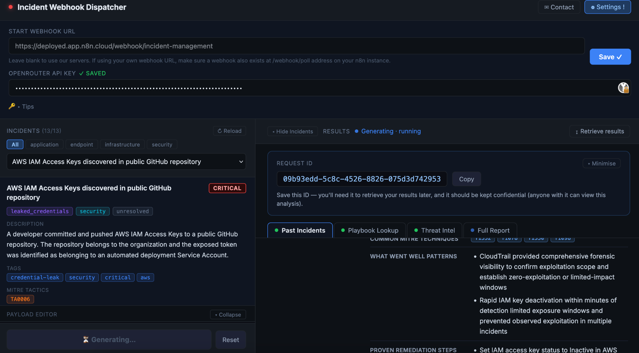

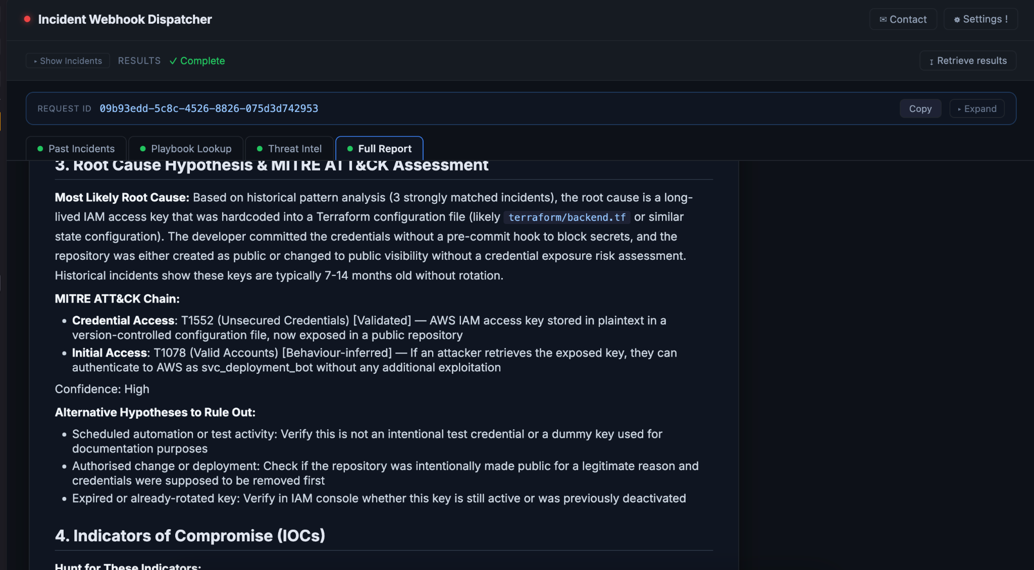

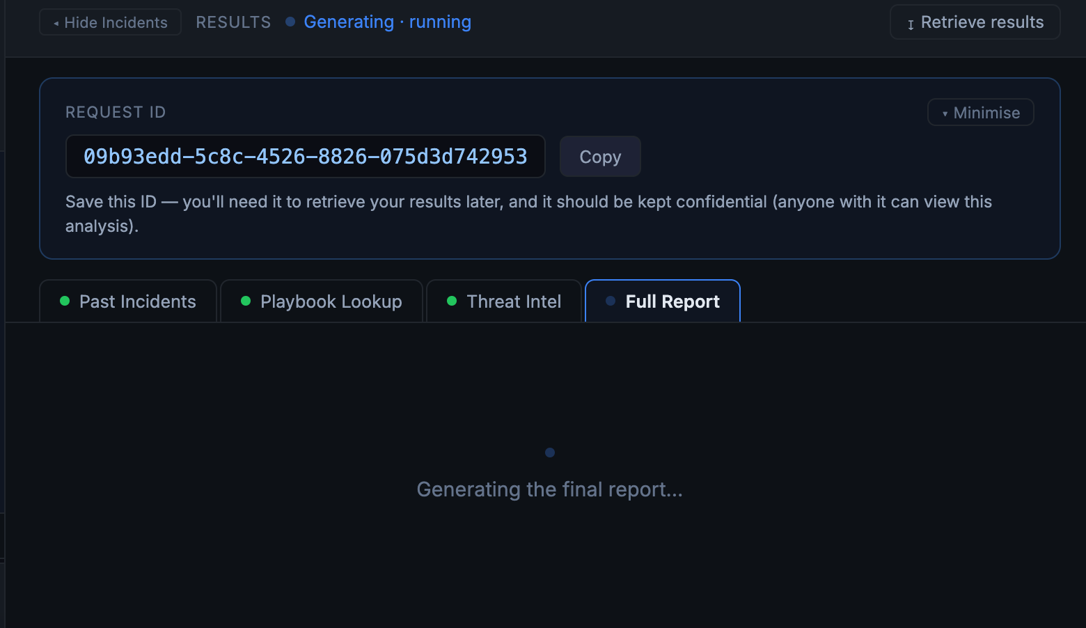

The easiest way to test this is using the UI we have built: https://incident-response.deployed.engineer. This allows you to fire JSON payloads at the workflow (which we have hosted on n8n cloud). There is a LLM cost per request so we ask that you get a key from OpenRouter which is used for the LLM calls. Each run will cost a dollar or two.
The workflow is available as a template on n8n to set up on your own instance. You will need four credentials: Supabase, Google AI Studio (for Gemini embeddings) or similar, OpenRouter or similar, and optionally, Tavily. All have free tiers. Detailed documentation is available on Github.
Setup takes about 30 minutes with our demo data, most of which is waiting for ingestion. 13 test incidents are included in the sample data covering ransomware, phishing, brute-force, S3 misconfiguration, and insider threat. Test-ransomware_detection-001 is the best starting point it has a strong playbook match, strong historical match, and produces a well-labeled runbook you can inspect end-to-end.

  • On Github with detailed instructions for implementation in your environment
We’re welcome to contributions, discussions and feedback using Github issues here. For a white-glove treatment, if you are a Cybersecurity Analyst or Manager, you can get in touch here.
