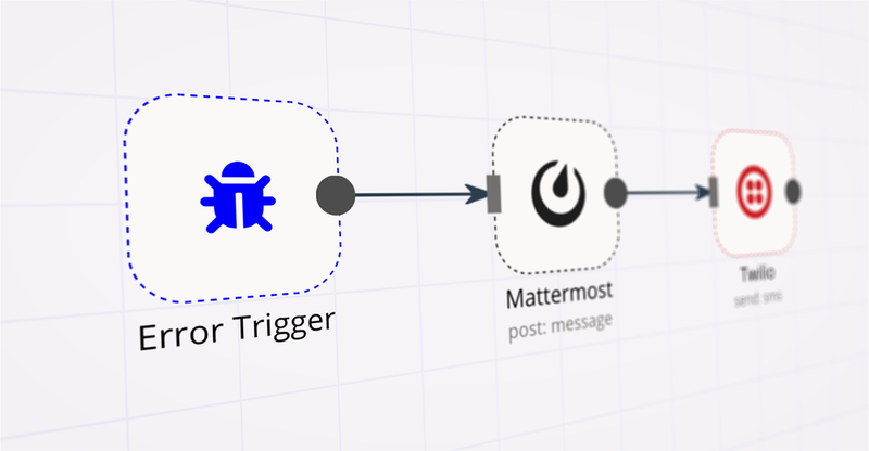

- Workflow 1: This will be an error workflow with an Error Trigger, a Mattermost node, and a Twilio Node. This workflow will be triggered when Workflow 2 encounters an error. It will then send a notification about the error to a Mattermost channel and an SMS.

1. Error Trigger: Start the error workflow

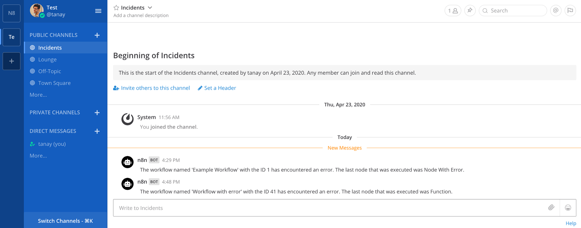

Finally, we will enter the Message. Since this would be a dynamic piece of information, click on the gears icon next to the field and select 'Add Expression'. I have entered the following expression using the Variable Selector.
The workflow named '{{$json["workflow"]["name"]}}' with the ID {{$json["workflow"]["id"]}} has encountered an error. The last node that was executed was {{$json["execution"]["lastNodeExecuted"]}}.Click on the Execute Node button and that will send a message to the ‘Incidents’ channel on Mattermost. Here’s a video of me following the steps mentioned above.

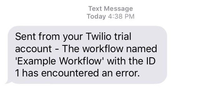

Once you have done that, add a Twilio node in n8n. Create new credentials for the Twilio API and enter the details. Now, enter the trial number that you created in the From field and your number (the one that you verified your Twilio account with) in the To field. In the message field, we want to include dynamic pieces of information. To do that click on the gears icon next to the Message field and select Add Expression. I entered the following in that field:
The workflow named '{{$node["Error Trigger"].json["workflow"]["name"]}}' with the ID {{$node["Error Trigger"].json["workflow"]["id"]}} has encountered an error.Click on the Execute Node button and that will send a message to the number specified in the node. Here’s a screenshot of how that looked for me.

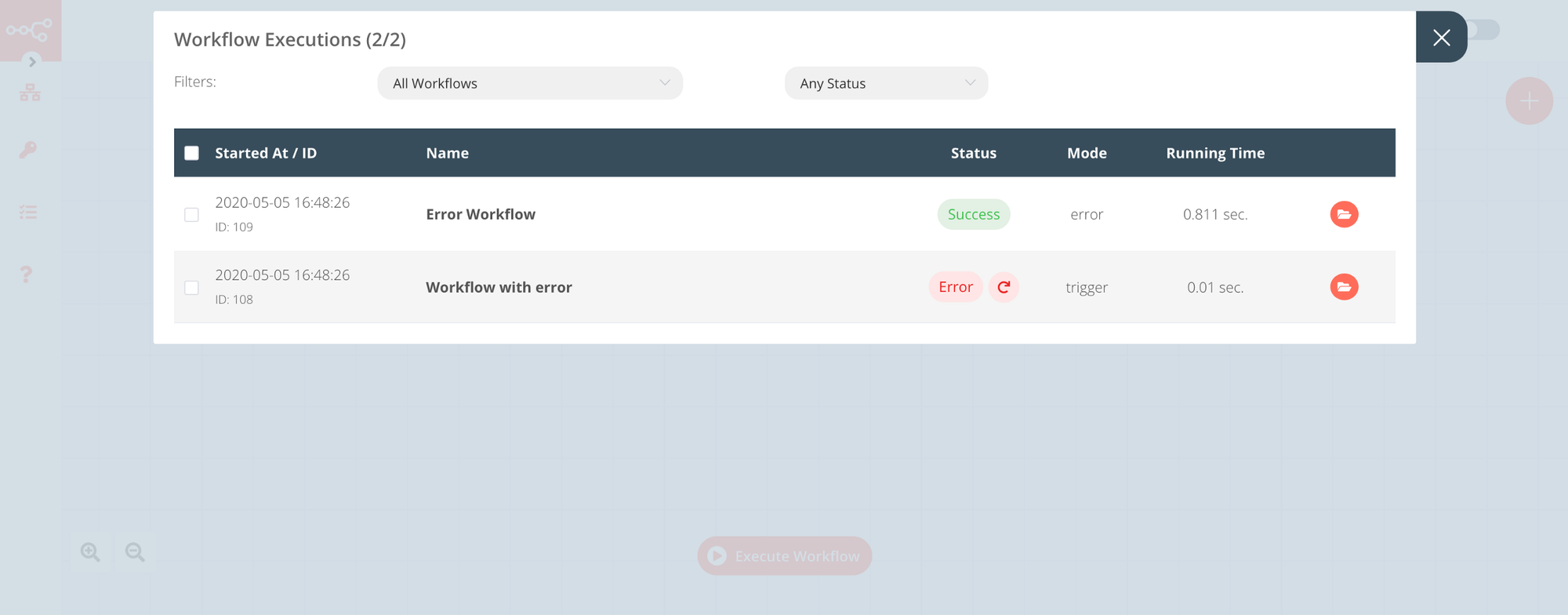

Activate the workflow by clicking on the Activate toggle on the top right. Voila, our workflow with an error is now live (never thought I’d say this) and will run every minute. You can keep an eye on the executions by clicking on the Executions icon on the left side of the screen. For me, it looks like the following after the first execution.
In the image above, you can see how the Error Workflow got triggered once the Workflow 2 encountered an error.

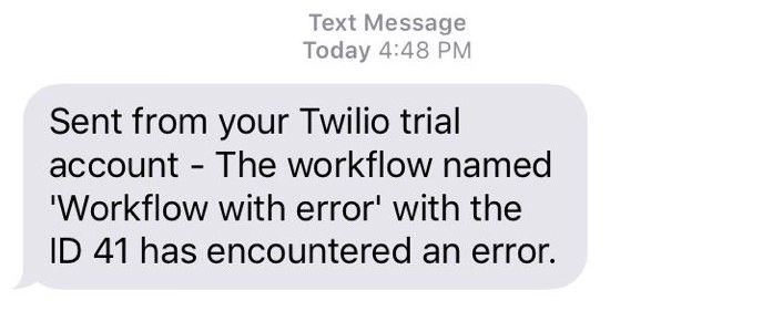

This is how the notifications from the Mattermost and Twilio nodes looked like after the Error Workflow got executed.
