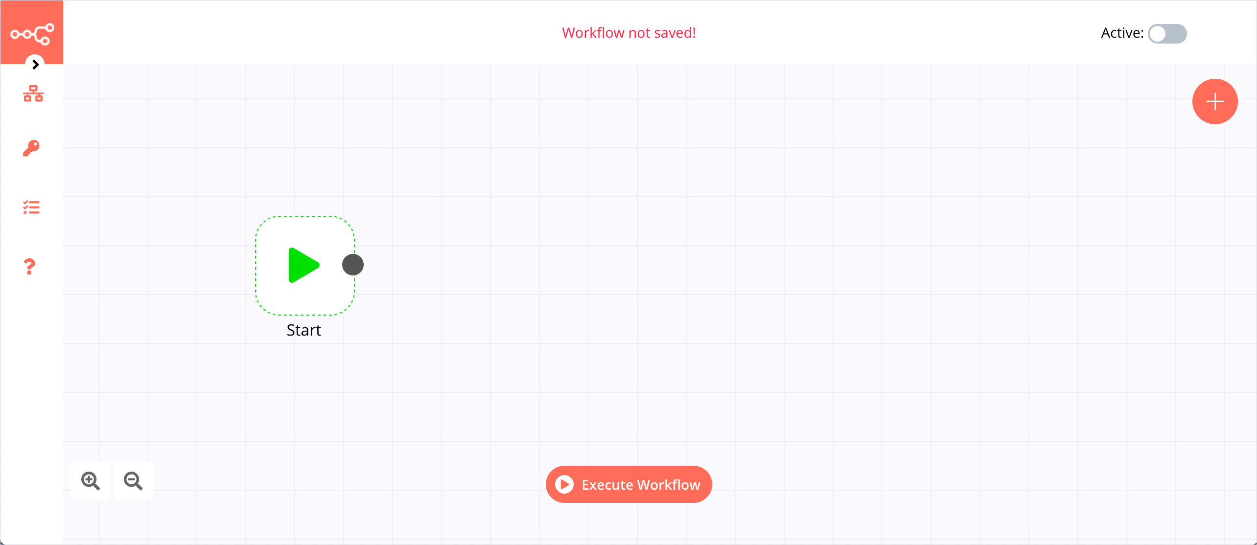

Type “o” in the terminal to open the Editor UI.
![](https://blog.n8n.io/content/images/2021/03/editor.png)
Let us now create a Trigger node, which starts a workflow when the webhook gets some data. In our case, it is the Telegram Trigger getting webhook data via the bot.

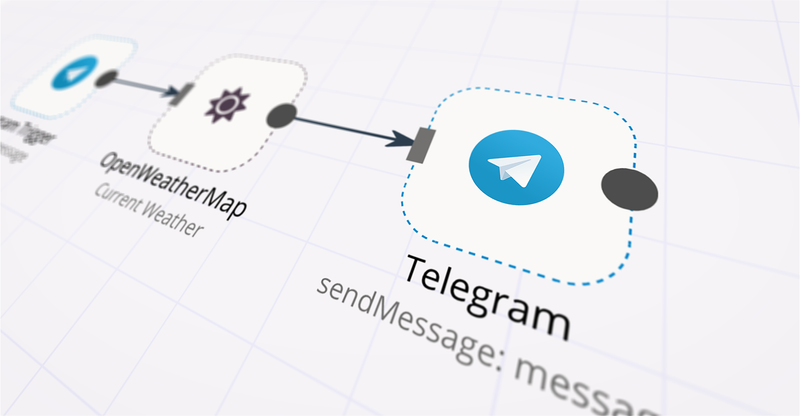

Our final component is adding a Telegram node that will send a message with the weather details back to the person who queried it.
Add a Telegram node like you added the nodes before. Before moving on to configure the node, make sure that you connect it to the OpenWeatherMap node before continuing. This will ensure that the node receives the data from the Telegram Trigger and OpenWeatherMap node for setting the configuration.

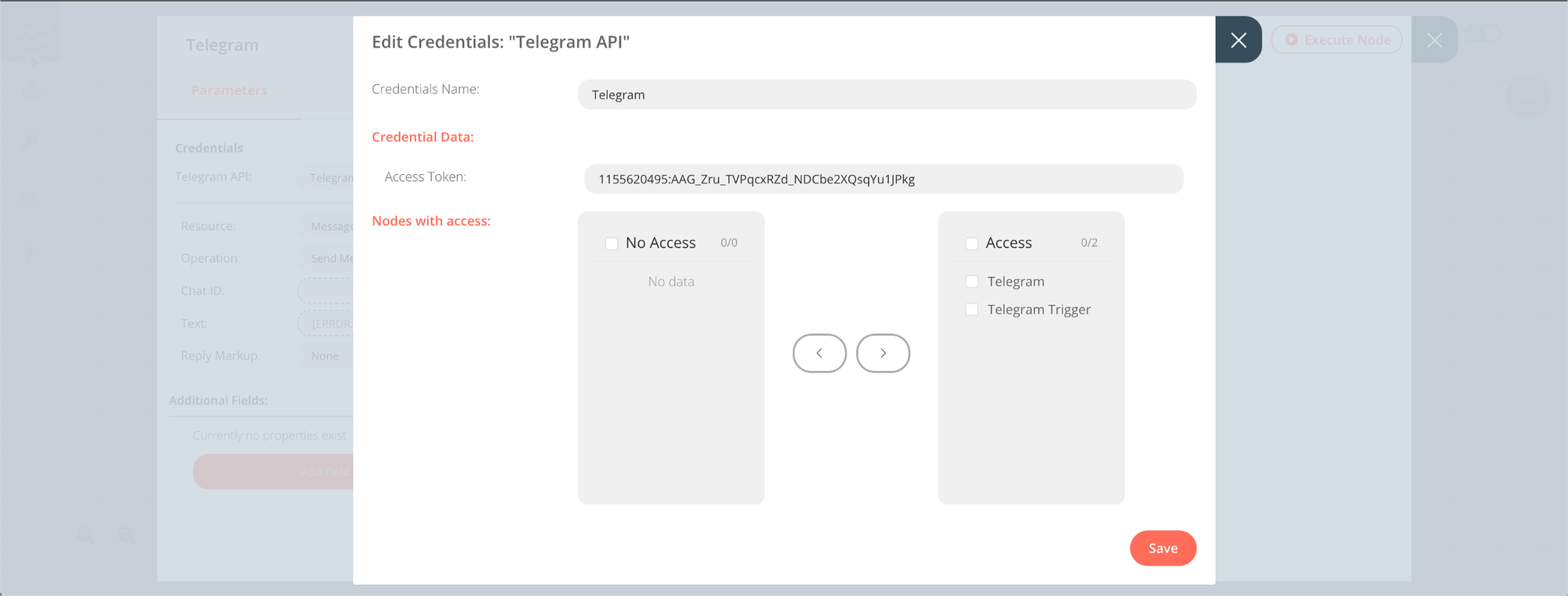

Now it’s time to configure the node. We already have the Telegram credentials that we entered early on and they can be re-used. Once you have selected the credentials, click on the pencil icon next to the credentials and make sure that you move the Telegram node from No Access column on the left to the Access column on the right. Once you are done with that, it should look like this.
![](https://blog.n8n.io/content/images/2021/03/credentials.png)
