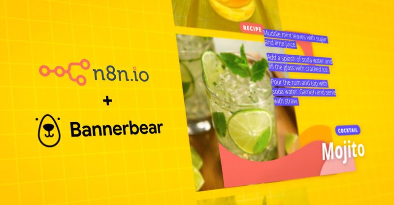

Below is a photo reference of our final template in the Bannerbear editor.
Finished Cocktail Recipe template
