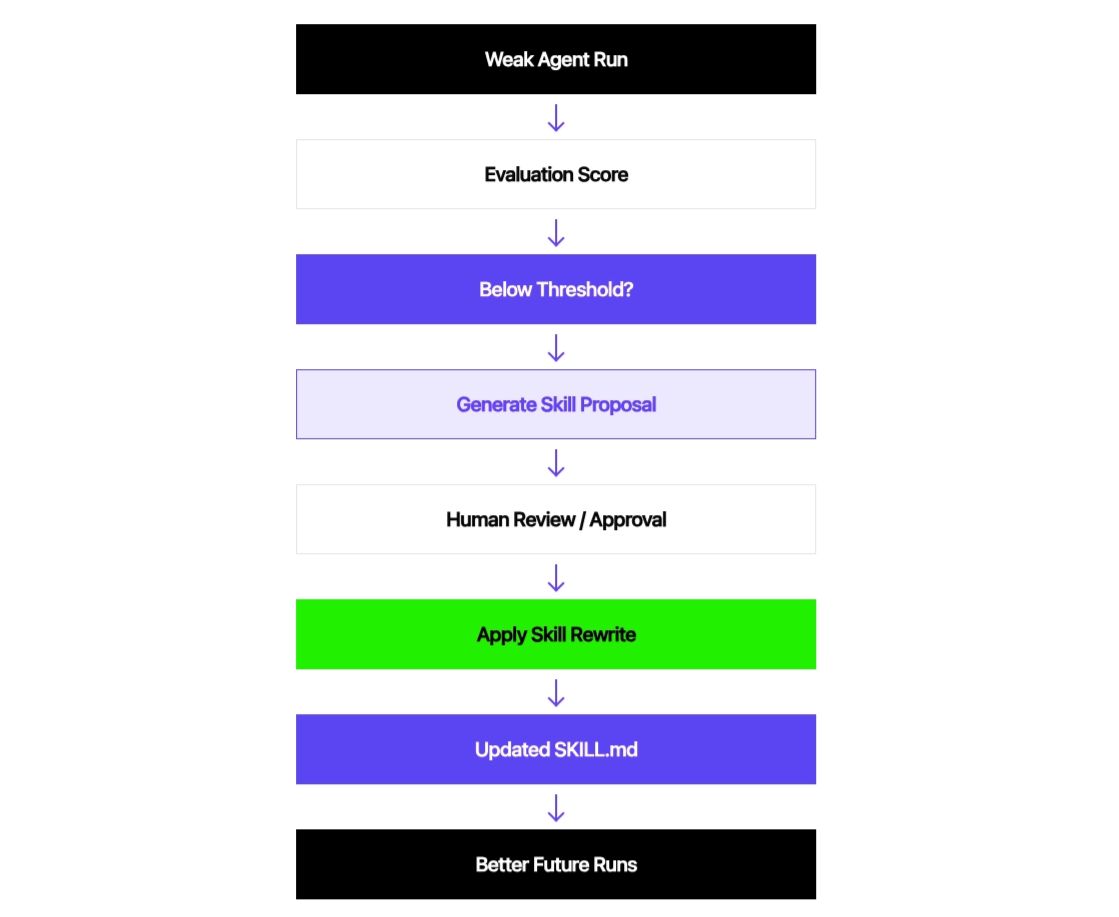

This tutorial builds a maintenance loop for those skills. When a review run scores below a threshold, the workflow records the feedback, asks cognee to propose a rewrite, routes that proposal through an approval gate in n8n, and, only after approval, writes the change back to the skill, with a before/after diff you can inspect, post to Slack, or attach to a pull request.
A weak run becomes an approved rewrite to SKILL.md, improving future agent runs.

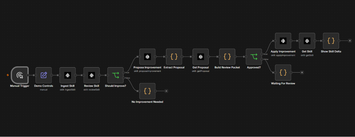

The visual workflow takes a sub-threshold-scoring agent run and turns it into a reviewable, approvable update to a Markdown skill file.

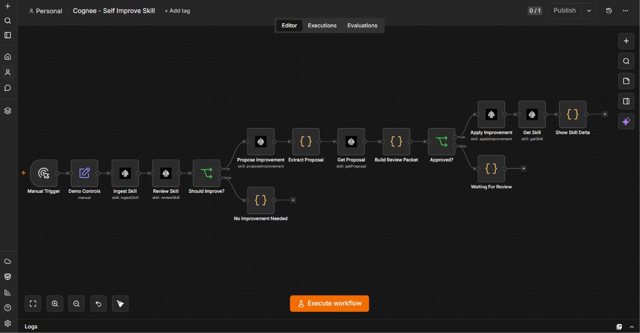

The self-improving skill workflow in the n8n editor
It runs these steps:

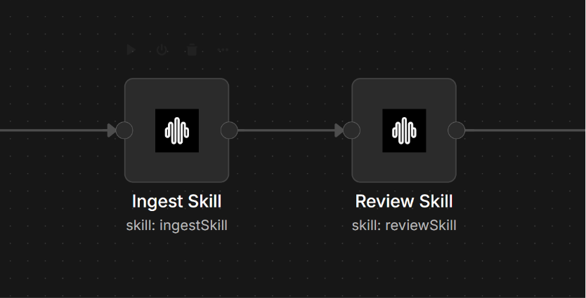

  1. Ingest Skill loads the local code-review skill into cognee
  2. Review Skill runs the review task with the skill loaded
  3. The review comes back with a score
  4. Should Improve? checks the score against the threshold
  5. Propose Improvement records feedback and creates a proposal (not applied)
  6. Get Proposal fetches the before/after for review
  7. A Code node builds the diff; the Approved? gate decides
  8. Apply Improvement writes the approved change
  9. Get Skill + Show Skill Delta confirm and output the result

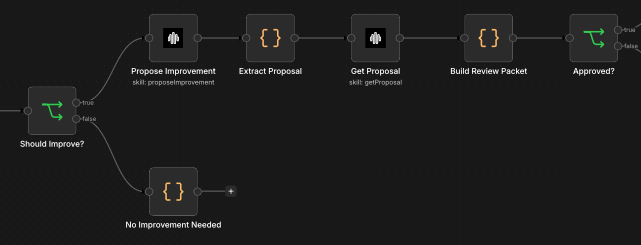

The Should Improve? IF node compares the review’s score (from Review Skill) to the threshold:
score < score_threshold
If the review scored below the threshold, the workflow takes the improvement path. If the score meets or exceeds the threshold, it routes to No Improvement Needed and exits cleanly. The threshold lives in n8n, is visible and adjustable, and is easy to swap for a stricter evaluator (an LLM-as-judge node, a CI score) without touching the cognee steps on either side of it.
The split of responsibility: the agent grades its own review against the score_instructions rubric, the verified node parses those per-dimension grades into one score, and n8n owns the threshold decision.
Step 5: Propose an improvement (verified node)
The Propose Improvement operation records the weak run and asks cognee for a rewrite. Crucially, it creates a proposal but does not apply it:
JSON
  "items": [
    { "kind": "skill_run", "run_id": "82a14c99…", "success_score": 0.42 },
    { "kind": "skill_improvement_proposal", "proposal_id": "48d6f3f3-430f-460c-bf5b-2987086a43dd", "status": "proposed" }
The proposed change stays in a holding state until n8n decides what to do with it. A single weak review can never silently rewrite your instructions.
Step 6: Review the diff before approving (verified node)
This is the step that makes the loop safe. The “Get Proposal” operation returns the proposal’s full before/after, plus the model’s rationale and confidence:

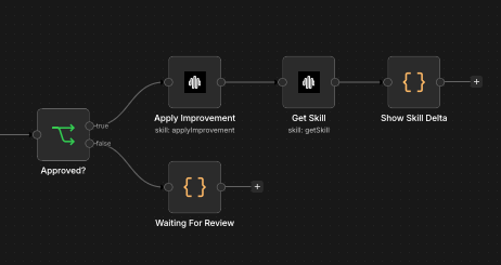

The Approved? IF node checks the approval flag. In the demo that’s the approved control; in production you’d replace it with a Slack message plus a Wait-for-webhook approval (see the sticky note on the canvas).
On approval, Apply Improvement updates the stored skill in cognee (status flips to applied):
JSON
{ "items": [{ "kind": "skill_improvement_proposal", "proposal_id": "48d6f3f3…", "status": "applied" }] }
Step 8: Confirm the result
Get Skill reads the skill back so you can confirm the new procedure is live, and Show Skill Delta emits the final skill_delta / skill_delta_markdown. One missed authorization check → one concrete, approved edit to the instruction that was responsible for missing it.

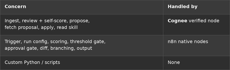

Who does what
The whole point of the visual build: you run the entire loop without writing a line of code.
