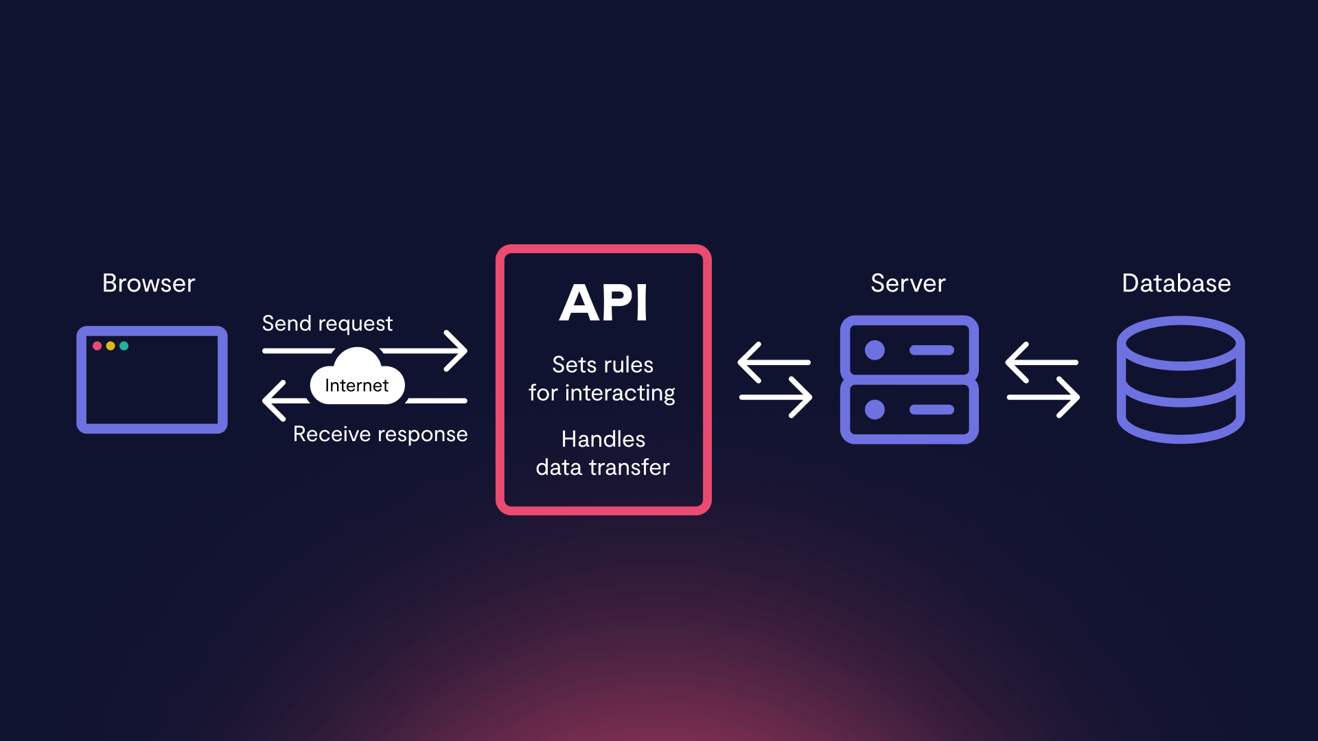

An API sits between two systems allowing them to exchange data seamlessly whilst abstracting the low-level details of the interacting systems from each other.
Following our definition of APIs, it’s easy to think that an API is a standalone system that is separate from the two systems, but no, it’s not. APIs usually come built into the systems that expose them. Not clear?
Okay, for example, let’s take Twitter APIs.
When we talk about Twitter’s APIs we are talking about the different interfaces that Twitter exposes, through which other applications can send data to or receive data from Twitter.
So, when we talk about Twitter’s API, we are not referring to an entirely separate system that sits between Twitter and other applications needing to communicate with it. Instead, we are referring to a component of Twitter that provides some service to other applications. ‘Service’ here is any task that Twitter performs which is of utility to another application or user. For example, an application might want to access Twitter’s trending tweets from its API.
Stretch the above example to other software systems and you have your definition of an API – the set of functions that allow an application to interact with other external systems. The interaction here implies sending or receiving data as well as requesting the external system to execute some task.

Recall that APIs essentially allow two systems to communicate – the communication between these two systems each having its API usually happens in the following order:
  1. You’d have a system, system A, that connects to the API of another system, system B.
  2. System A makes a request to the API of system B.
  3. The API of system B passes the request to some business logic in the system that then processes the request.
  4. Finally, the API of system B then returns the result of that processing to system A.
In the API parlance, the system making the request is called the client, the system serving the request is called the server, and the result returned to the client is called a response.

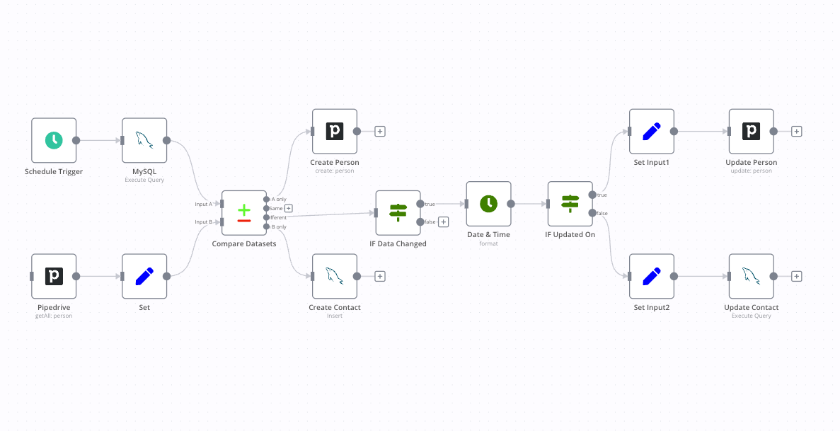

For example, think of a scenario where you need to set up a two-way data sync between Pipedrive and MySQL.
Two-way data sync between Pipedrive and MySQL in n8n
If as we have mentioned, each sub-process in a workflow is represented by an n8n node, then we are going to have several nodes linked to each other in our Pipedrive and MySQL workflow. For example, we will have the MySQL and Pipedrive nodes in our workflow amongst others.
From a more technical standpoint, these nodes serve as an entry point for retrieving data, a function to process data, or an exit for sending data. The data process performed by nodes can include filtering, recomposing, and changing data.
This begs the question, how do these nodes retrieve data?
Well, the nodes (integrations) that you see use APIs provided by different services to allow you to interact with these services within your workflows.

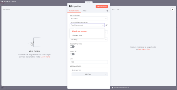

Thus, in our case, our workflow will interface with the APIs of Pipedrive and MySQL via the Pipedrive node and the MySQL node respectively. Keep in mind that to work with this workflow you need to configure the credentials for the Pipedrive node and the credentials of the MySQL node.
Pipedrive credentials for n8n
With this Pipedrive to MySQL integration you can keep data in sync – meaning, when you update shared data in one of the platforms, it automatically gets updated on the other platforms. It demonstrates an obvious benefit of API integration with n8n.
This bidirectional data sync powered by API integration also helps to preserve data integrity - this is true because data has to be updated in only one location.
