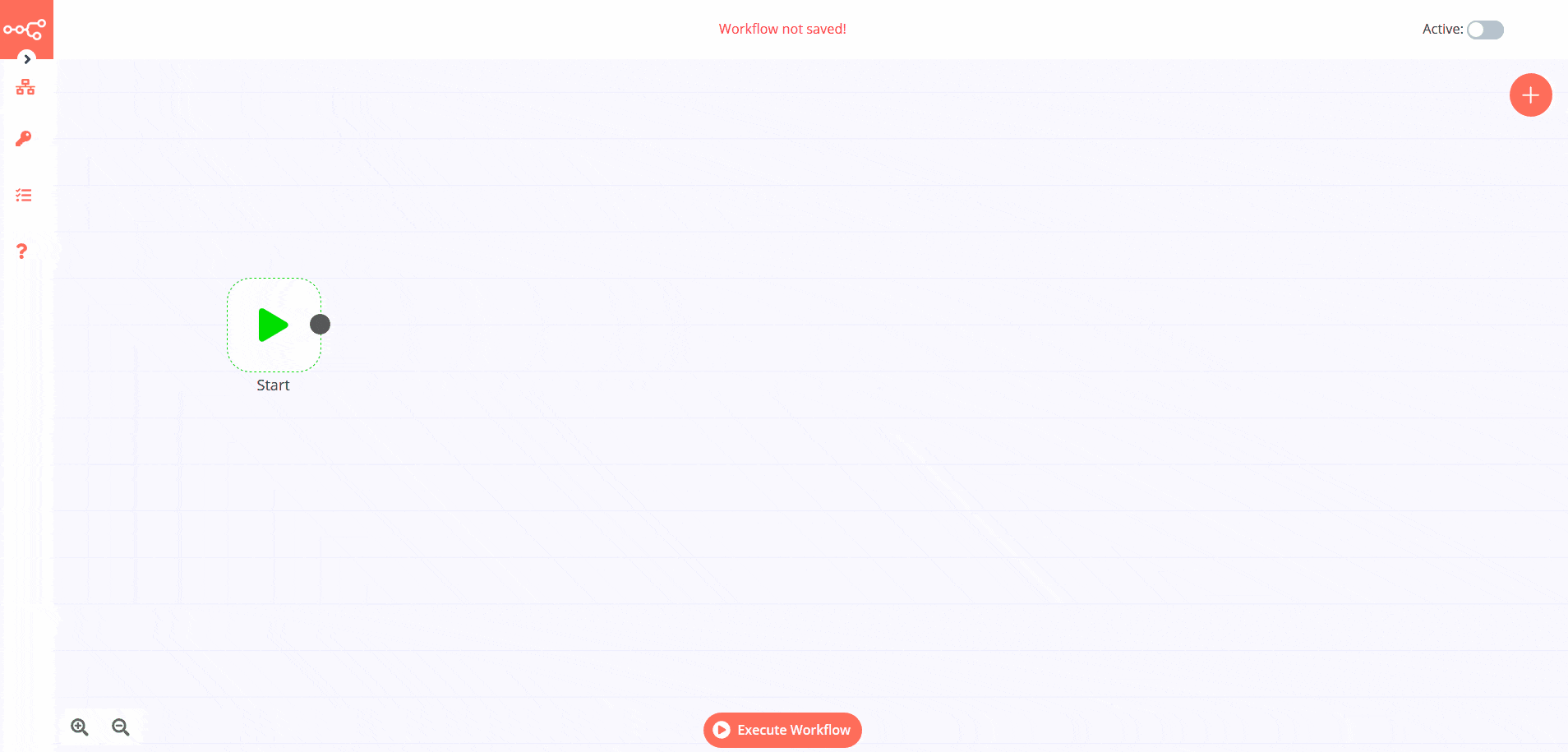

When prompted, press ‘o’ in your terminal to open the local address in your browser and begin automating workflows. You’ll be met with this screen.

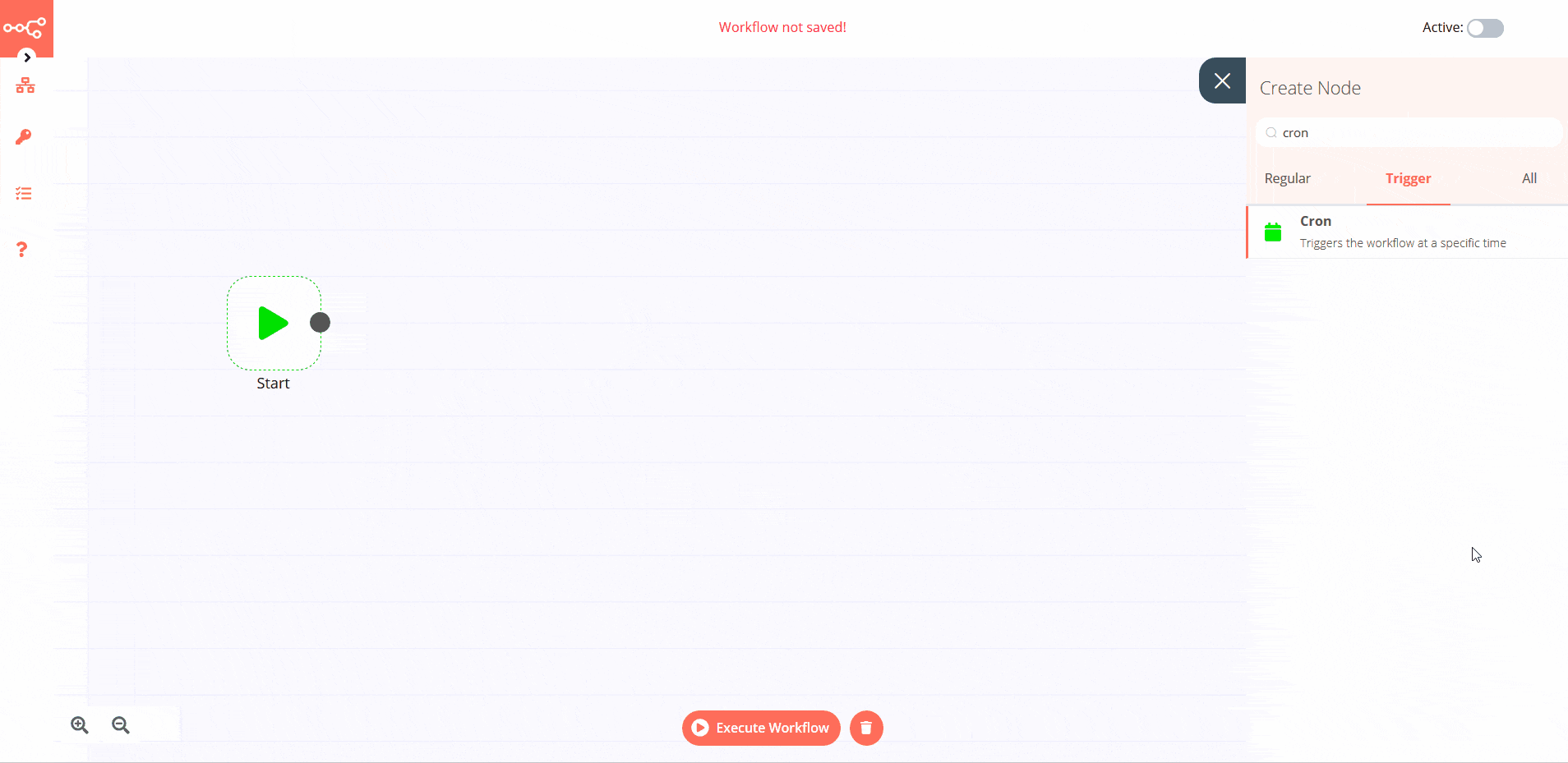

n8n calls integrations nodes. It has a good number of third party nodes and inbuilt nodes. Sometimes, nodes can be used to trigger or start a workflow. To start it off, we’ll add a Cron trigger that will start our workflow at a specific time. If you click the + in the top right corner, you open up a menu of nodes. Click on the trigger tab and search for Cron. Click on it to add the time you want it to be triggered.
Click on the Execute Workflow button and you should see a small alert in the bottom right corner telling you that the workflow ran successfully.

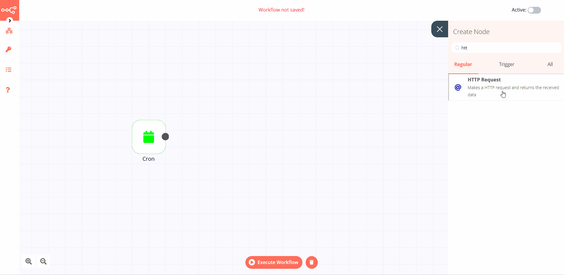

Again, we click the + in the top right corner and search for HTTP and click on the HTTP Request node. Paste https://affirmations.dev in the URL section and execute the workflow. Successfully runs again but this time you get some data, which is always good when making a request. Close the modal. Click and hold the circle on the Cron node and drag it to the left side of the HTTP Request node. This way, we’re telling n8n that when the Cron node is triggered, we need to make a request and return some data.

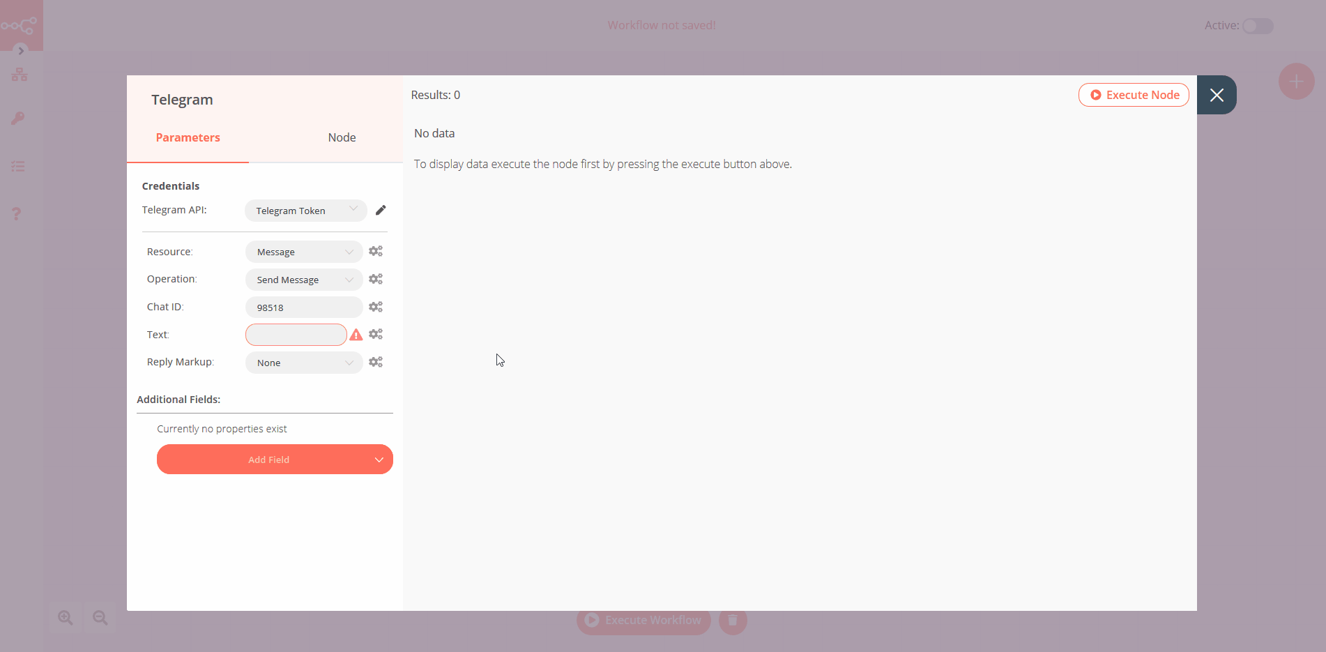

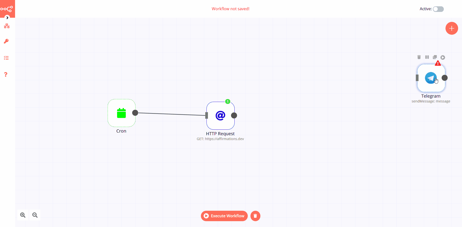

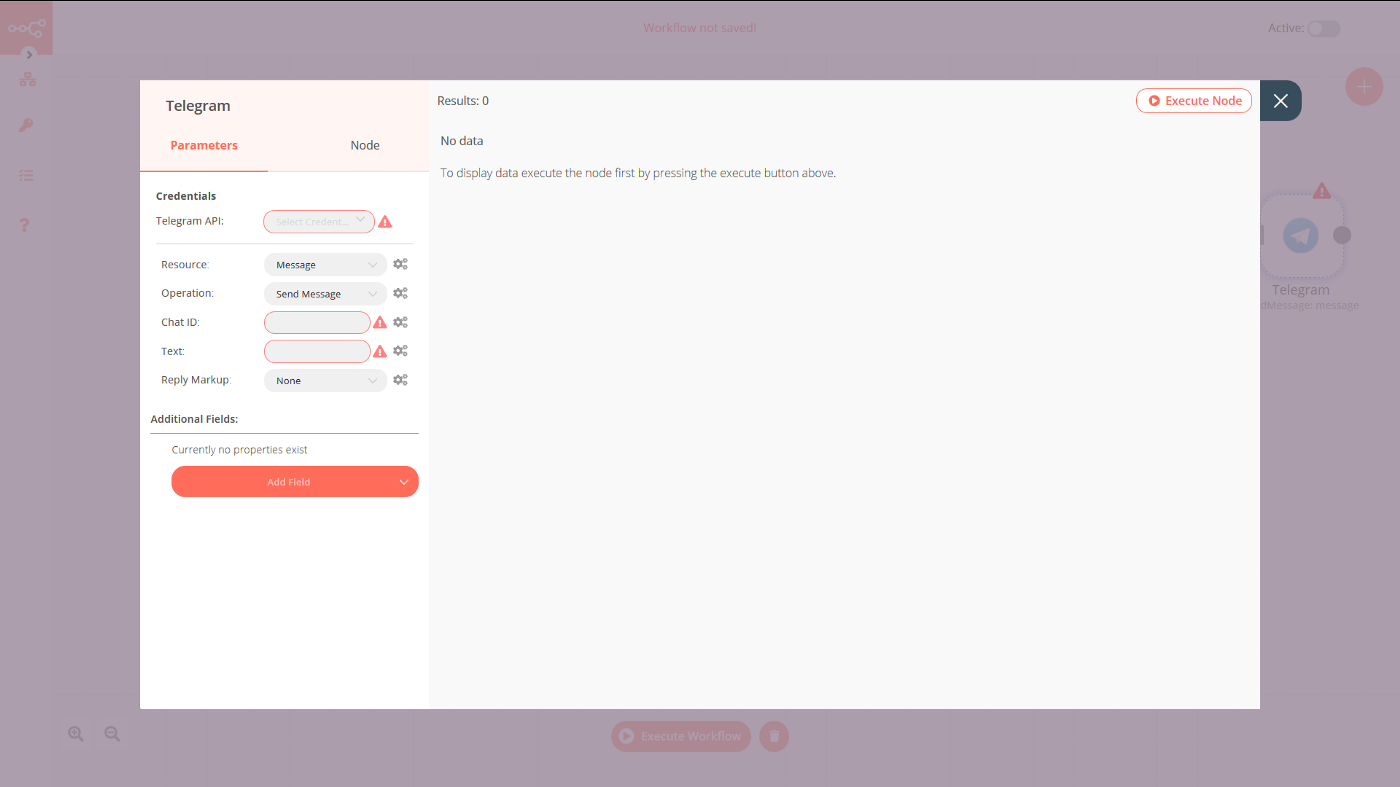

We’re being returned affirmations in JSON format and we want to be able to send these out via Telegram. We have a Telegram node at our disposal. As we did before with the Cron and HTTP Request nodes, search for and click on Telegram.
Telegram node’s required fields
There are a few fields highlighted and we don’t have that data yet. So before we use the Telegram node, we have to get those details. Here’s what we need to do:

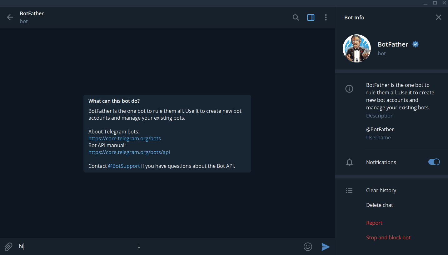

  • Talk to the Botfather, a bot we use to create our bot.
  • Here, you give your bot name and unique username and get back a URL that directs you to the bot and token to access the bot via HTTP, we need to keep this safe. Click on the bots URL (t.me/<bot username>) and press start when taken to its chat window.
Setting up your Telegram Bot with Botfather

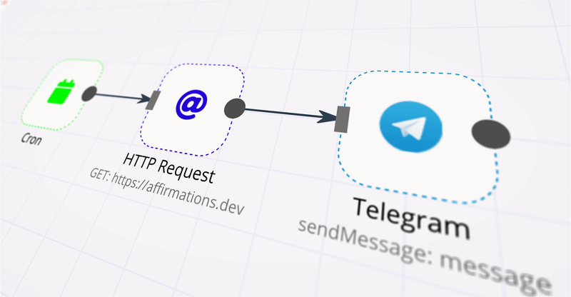

We connected the HTTP Request node and Telegram so we can send the response as a message. n8n lets us take data from other nodes and use it in different fields. In our case, we’re getting the response data from the HTTP Request node and adding it to a message that we’ll send using the Telegram node.
We open the Telegram node, click the gears next to the text field, and click on Add Expression. We have two sections — variable selector and expression. In the expression section we type out the message and because we want the affirmation to be sent at the end of the text we make a few new lines before we head over to the variable selector. We use this section to “interpolate” data from other nodes into the main expression. To select the data, we click on the Current Node > Input Data > JSON and then select the JSON property we want which in our case is affirmations. This way, at the end of the expression “Hey Daniel, here is your daily affirmation”, we have a different affirmation every day depending on what the API request returned.
Formatting message data by editing Telegram expressions

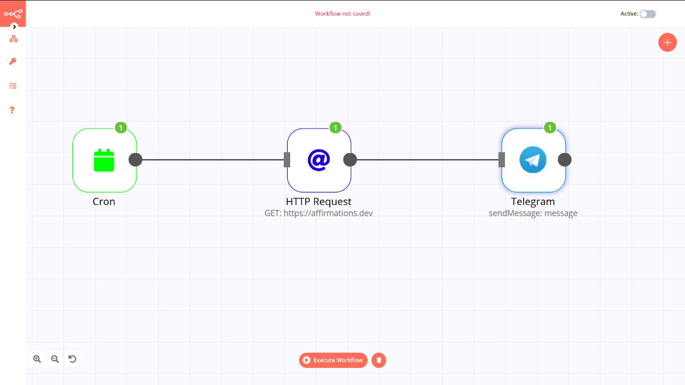

Add your Chat ID and made sure all other credentials in the Telegram field have been filled. We’ll leave the chat operation as send message because that’s what we’re going for. Close the node and click on the Execute Workflow button.
Text Affirmations Workflow overview

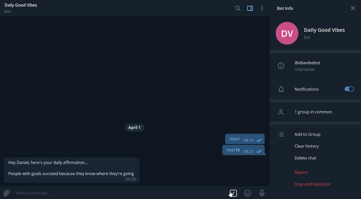

Check your Telegram and you should have a new message from your Daily Good Vibes bot.
