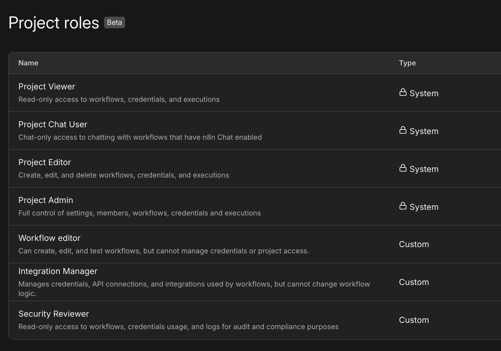

  • Custom Project Roles allow admins to create truly custom roles that are assigned at the project level. They enable organizations to model real operational roles, such as workflow builders, reviewers, operators, or platform admins, and apply least-privilege access across workflows, credentials, folders, and source control. When combined with environments, these roles help teams build and iterate safely without risking changes in production.

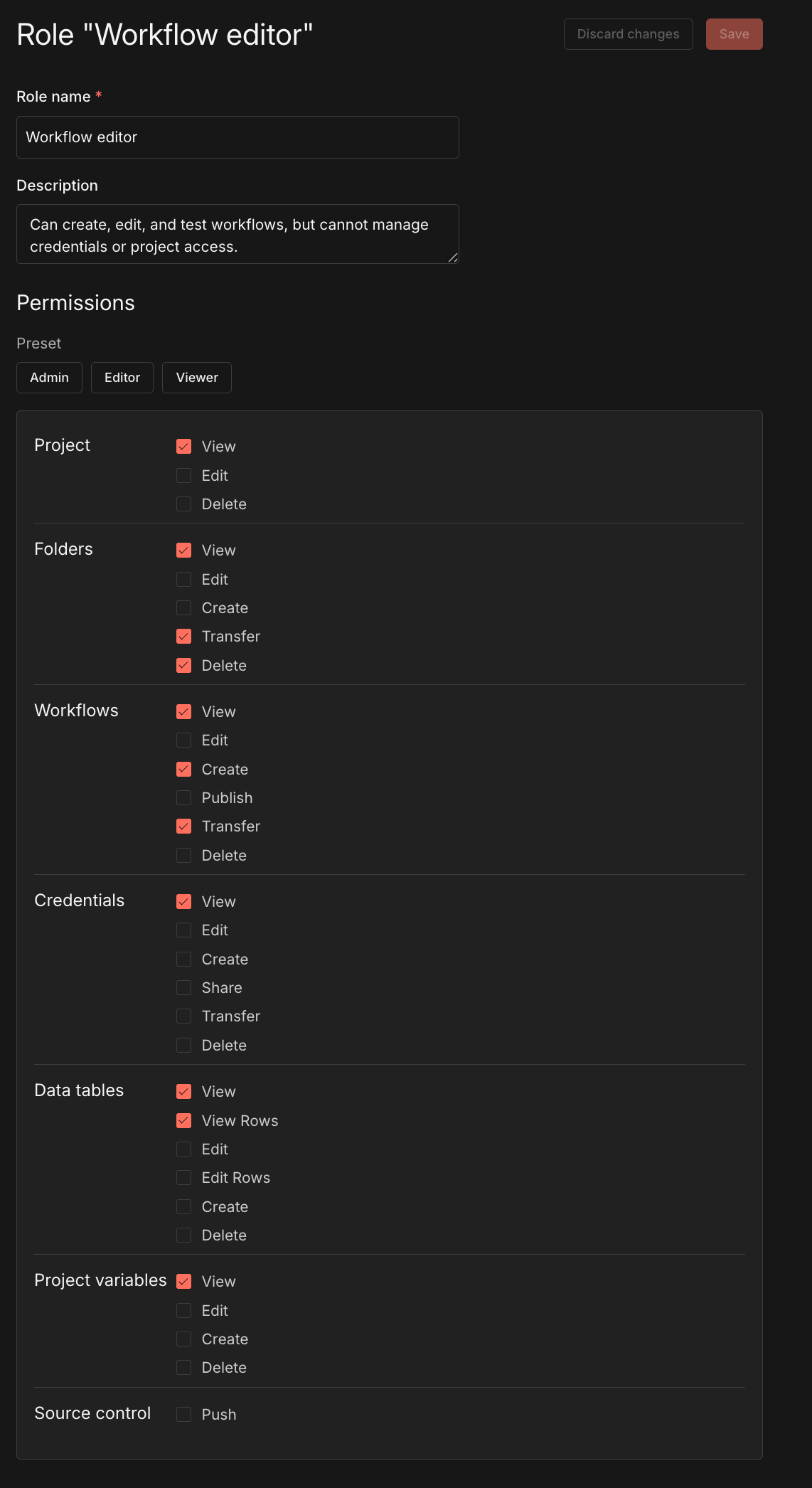

Custom Project Roles (project-scoped RBAC)
Custom Project Roles is an enterprise feature that allows admins to define custom roles at the project level, with granular permissions. Roles are created and managed from a dedicated Project Roles section in settings. Permissions are then applied within projects rather than relying only on broad, instance-wide roles.
You can now create custom roles tailored to your needs, giving you granular control over user permissions within projects.
How it works
Admins define custom roles by selecting permissions within a project-scoped model. The current permission surface includes:
  • Projects
  • Folders
  • Workflows
  • Credentials
  • Data tables
  • Variables
  • Source control

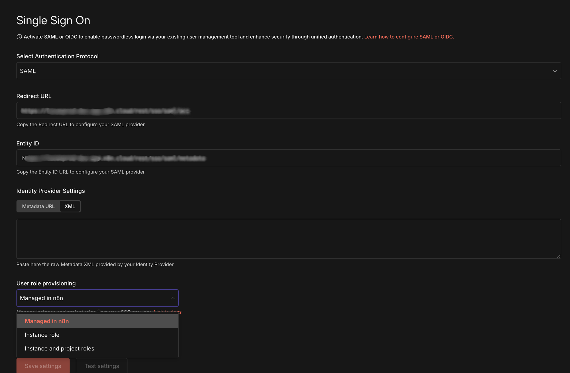

User provisioning (IDP-driven role sync)
User provisioning automates access management by syncing users and roles from your identity provider (IdP) into n8n at both the instance and project level.
You can configure n8n to provision users individually or via IdP groups, and automatically assign them to the appropriate project(s) and role(s) as part of your existing IAM setup.
This includes support for:
  • System roles and custom roles you define in n8n
  • Project-scoped role assignment driven by IdP group membership
  • Automatic updates when users join, change roles, or leave groups in the IdP
As a result, access management scales cleanly as your organization grows:
  • Onboarding and role assignment follow established IAM processes
  • Changes in IdP membership are reflected automatically in n8n
  • Access control becomes consistent, auditable, and repeatable across teams and projects
Choose between managing your users direct inside n8n or provisioning them and their access via your IdP
You can learn more about SSO and user provisioning in our documentation page.
