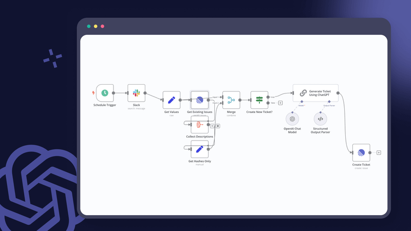

Step 4. Create a new Issue template automatically using AI
Now the fun part! Given our customer request, we can instruct AI to summarise and paraphrase to generate a succinct title and a description for the issue. Not only that, we can also use AI to generate possible debugging steps or solutions to try if the query is generic or even connect with internal systems to pull relevant documentation in the right scenario. There are a lot of ideas to try but we’ll keep it simple in this tutorial and just have the AI generate a standard issue. Additionally, we will also instruct our AI to determine the urgency of customer requests and assign the appropriate priority label to the issue.
  • Create a Basic LLM Chain Node with the following instruction:
  • Customer Message: “{{ $('Get Values').item.json.message }}”
    You will complete the following 4 tasks:
    1. Generate a title intended for a support ticket based on the user issue only. Be descriptive but use no more than 10 words.
    2. Summarise the user issue only by identifying the key expectations and steps that were taken to reach the conclusion.
    3. Offer at most 3 suggestions to debug or resolve the user issue only. ignore the previous issues for this task.
    4. Identify the urgency of the user issue only and denote the priority as one of "low", "medium", "high" or "urgent". If you cannot determine the urgency of the issue, then assign the "low" priority. Also consider that requests which require action either today or tomorrow should be prioritised as "high".
  • Ensure the “Require Specific Output Format” is checked
  • Click the “Output Parser” button and attach a “Structured Output Parser” subnode.
  • In the “Structured Output Parser” subnode, add the following schema
  • { "type": "object", "properties": { "title": { "type": "string" }, "summary": { "type": "string" }, "ideas": { "type": "array", "items": { "type": "string" } }, "priority": { "type": "string" } } }
Step 5. Create a new issue in Linear
Now we have our issue title, description and priority label generated by AI and our message metadata from Slack, we can combine the two to create an actual ticket in Linear.
  • Add a Linear node which performs a create operation for the issue resource. Ensure the Team name or ID is set to the project you want to capture the ticket.
  • In the Linear node, map the outputs of the LLM Chain node along with those of the Slack node we set up earlier in the workflow, to the respective title, description and priority fields.
