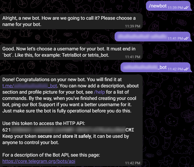

Step 0. Add a new bot in Telegram
Telegram allows adding a new bot in just a minute!
The official way is by using BotFather. Start this bot and follow 2 easy steps:
  • First, run /newbot command and give your bot a human-readable name
  • Next, provide a unique bot name. Telegram requires that a name should contain “bot” or “_bot” at the end of a name.
After that, you’ll receive a confirmation with a secret API token.
You can also customize your bot via BotFather later: provide a description, add an avatar, set up a menu with bot commands. This is not essential for the scope of this tutorial.
Register new Telegram bot in just a minute

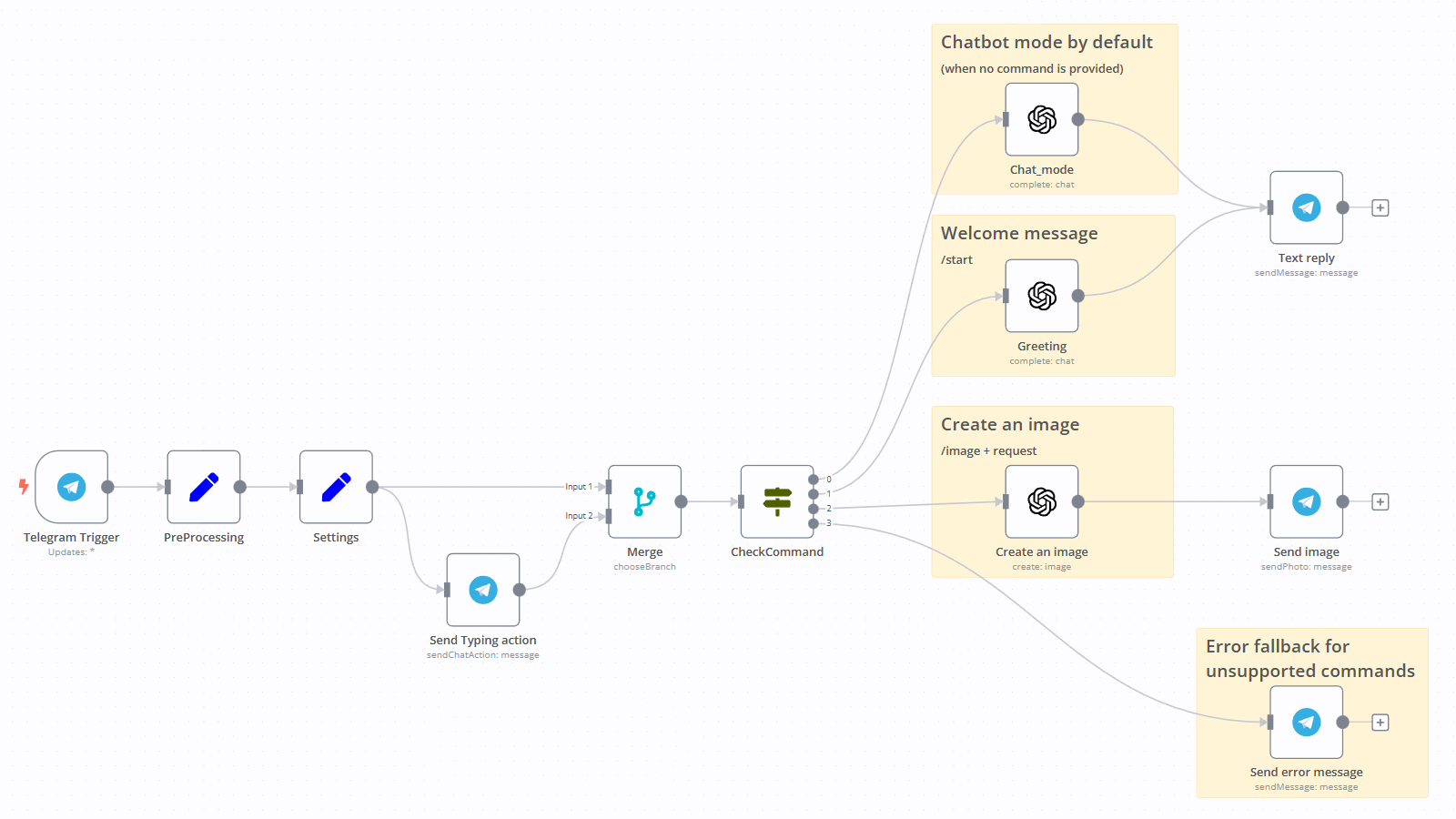

Let’s break down the bot’s workflow into three smaller pieces.

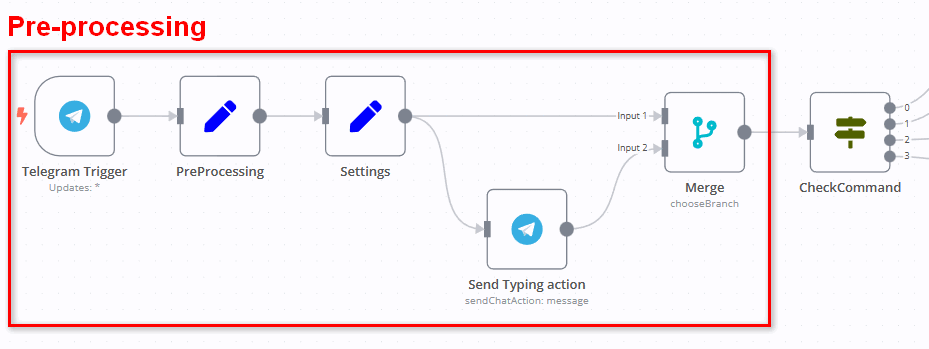

This part receives incoming message from Telegram and performs some preparatory steps
The first part receives incoming messages from Telegram and performs some preparatory steps:

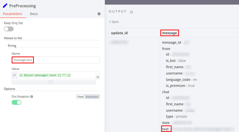

  • Telegram Trigger receives all possible messages by default. That’s how you can ensure that your bot doesn’t look idle even if certain actions are not supported yet.
  • PreProcessing step makes sure that json.message.text key always exists. This will help to avoid error messages in subsequent steps.
This step ensures that a JSON key always exists

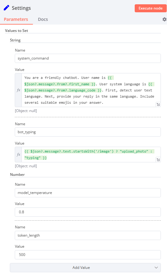

  • Now let's take a closer look at the Settings.
Settings store important GPT3/4 configuration parameters
system_command variable is the initial GPT prompt that instructs how your new chatbot should behave. We ask the bot to be friendly, reply in the user’s language and add emojis to ensure more natural replies. We also provide some additional context by adding the user's name and the Telegram app language. This information will help a chatbot to greet users by their names and take into account their preferred language.

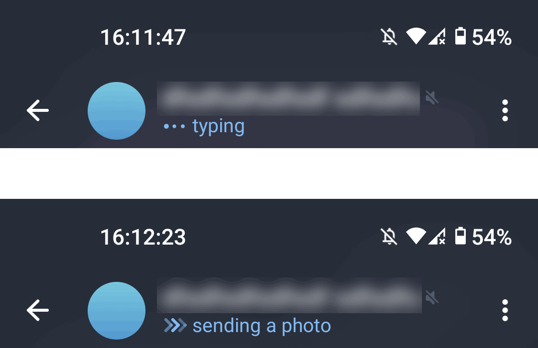

bot_typing variable is needed to provide typing notification while the bot is working on the reply. Notification depends on whether a user started their message with /image command or not.
An example of bot typing notification
An example of a bot typing notification
model_temperature stores the temperature value: the higher, the more “creative” chat completions the model will provide. Read more about GPT parameters on the API reference page.
token_length value limits the length of the answer from the GPT model.
  • Send typing action simply uses the value from the bot_typing JSON parameter.
  • Finally, why do we have a Merge node here? This node is configured in the ChoseBranch mode, which passes through the original JSON from Settings. This is a simple technique to ensure that Send typing action finishes before the next steps begin.
Step 3. Make API calls to OpenAI services

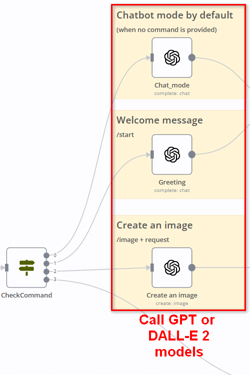

The next part of the bot routes the user data into one of three AI models.
This part of the bot decides which model should run depending on the user input

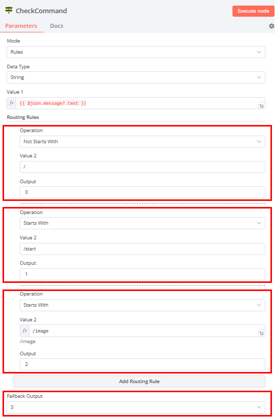

  • CheckCommand is a Switch node configured in the following way:
Switch node routes the requests to the corresponding AI models
The first three Routing Rules are valid requests, they are processed by either GPT model or DALL-E 2. The last rule is a fallback rule for unsupported commands.

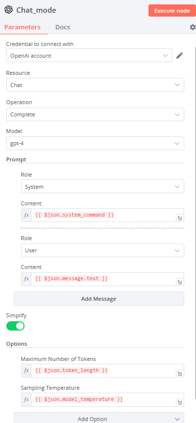

  • Simple text and a /start command (outputs 0 and 1) are passed to the OpenAI node for GPT chat completion.
OpenAI node configured in chat completion mode via GPT model

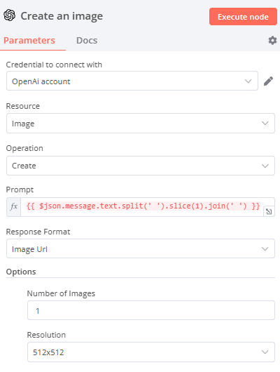

  • Output 2 goes to a different OpenAI model. DALL-E 2 model is a text-to-image neural network that can generate images from text inputs.
Example of OpenAI node configured for image generation

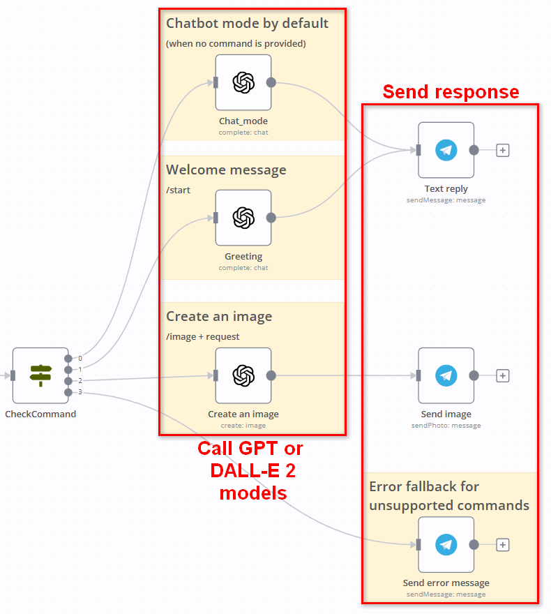

Step 4. Send the response back to a user
After OpenAI models return some response (text message or an image), we need to pass this information back to the user. Also, we need to prepare a generic response for unsupported commands.
This part demonstrates how response nodes are connected with the previous parts
  • You can see that Text Reply is connected to both OpenAI nodes. This is a small trick in n8n to reduce workflow redundancy.
  • Send Image passes through an URL that is returned from Create an Image.
  • Finally, Send error message returns a generic reply. This way we don’t call any OpenAI models and provide an immediate response.
That’s it! We’ve created a functional AI-powered chatbot in Telegram.
