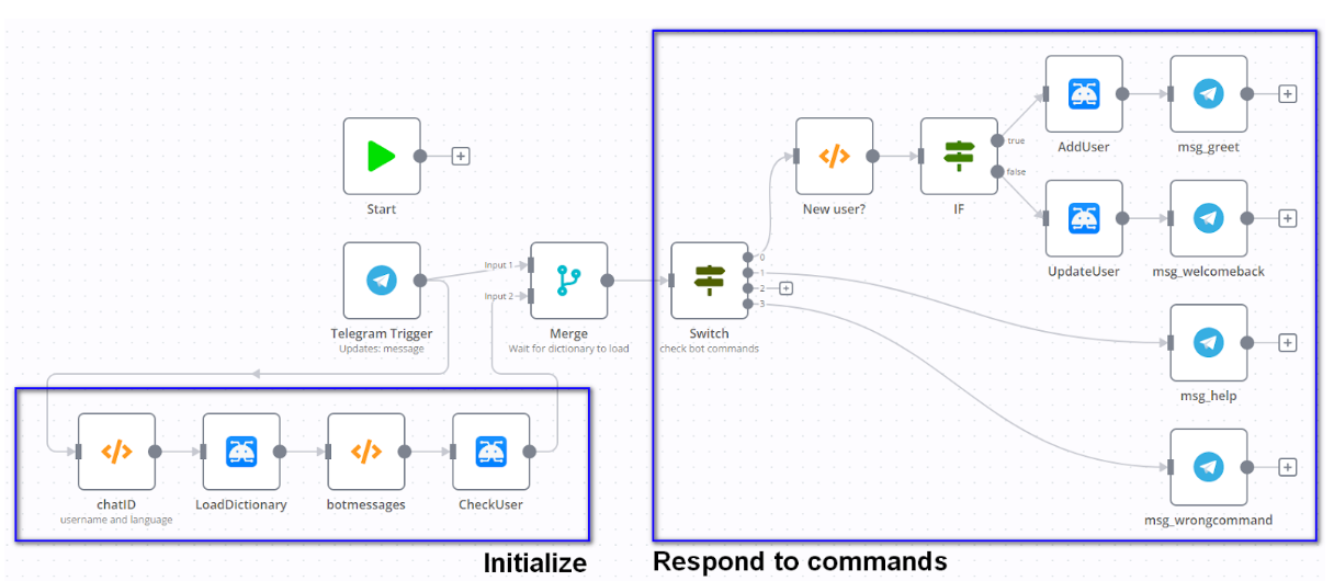

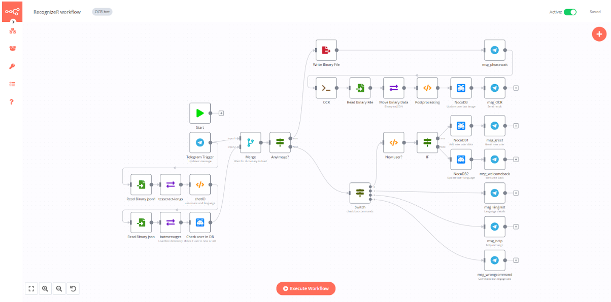

First of all, let’s have a general overview of a simplified workflow. I have created a skeleton of a multilingual bot that can reply to simple commands in several languages.
There are two sections of the bot:
- Initialization.
- Processing of bot commands (like /help or /start).

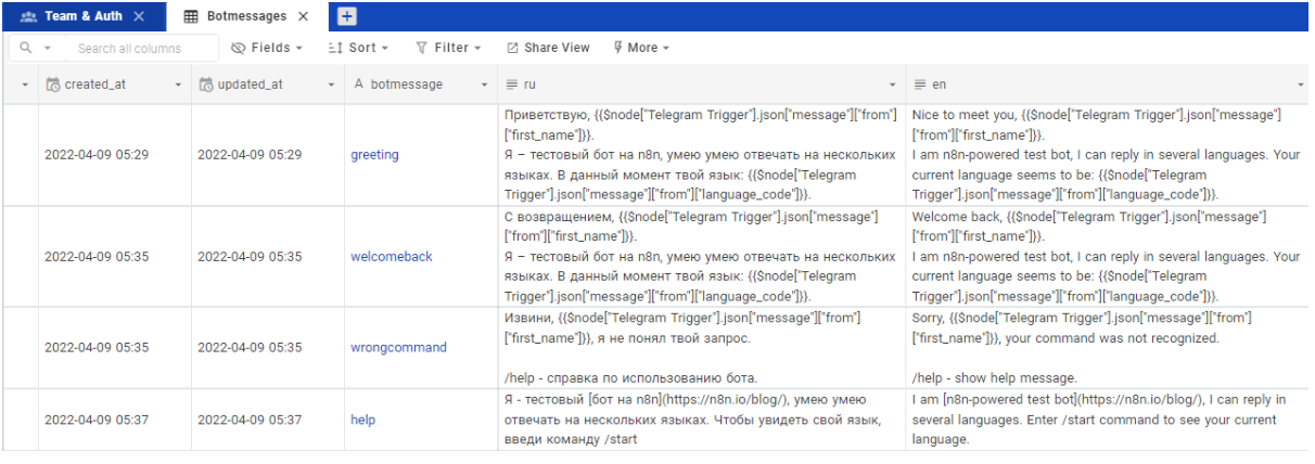

Bot dictionary
I created a dictionary that contains all possible phrases using NocoDB. Later on, specific messages are selected dynamically from the dictionary. This approach allows me to add many languages with virtually zero changes in a bot workflow. Here’s how the dictionary for several languages looks like:
Bot initialization
Each time the Telegram Trigger node is activated, an initialization process begins.
First, the user's language is detected and if it is not supported yet, then the default language is assigned:

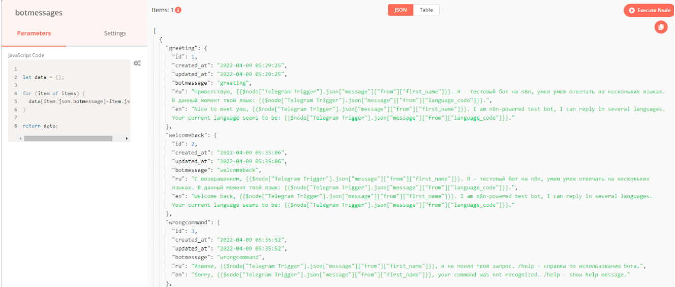

Each bot message can be reached now by its name, languages are nested inside each message. The resulting dictionary structure looks like this:
Finally, the bot has very simple user management: each new user is greeted, known users are welcomed back, and the original user language is stored in a NocoDB database.
After the initialization process is completed, I placed a Merge node. It is configured in a Pass-through mode and waits for the initialization to finish before actually processing the Telegram message.
Commands processor
Next section of the bot is a command processor.

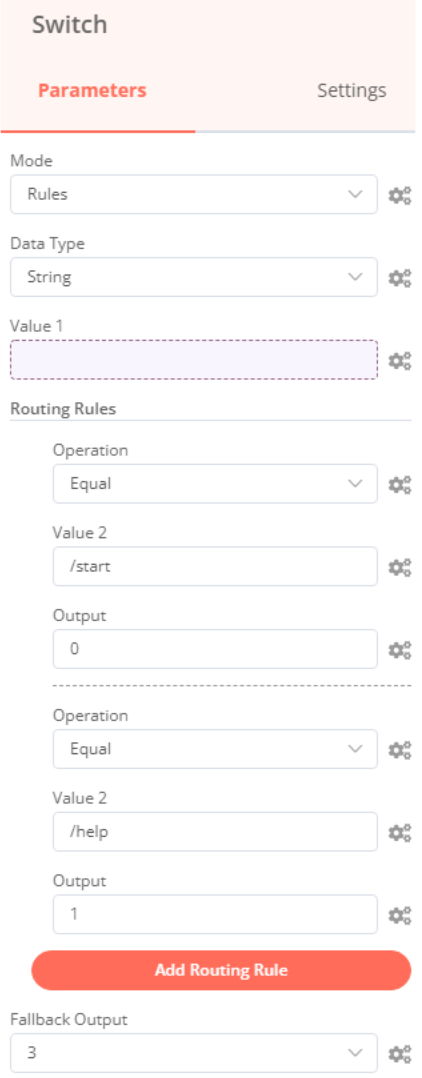

Since the bot supports only a few commands, one Switch node is enough.
The bot supports only two commands right now: /start and /help. Every other text goes to the third output and is treated as an incorrect command.

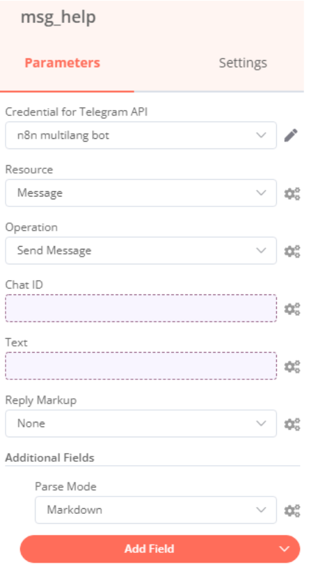

There are several Telegram nodes at the end of the workflow, all configured in a similar way.
The Parse Mode is set to Markdown, because the help message contains a link to the n8n website.

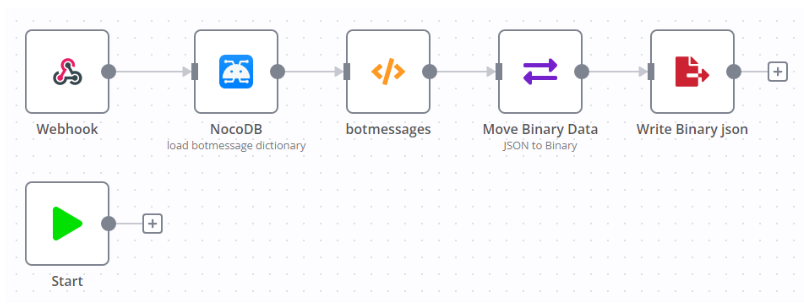

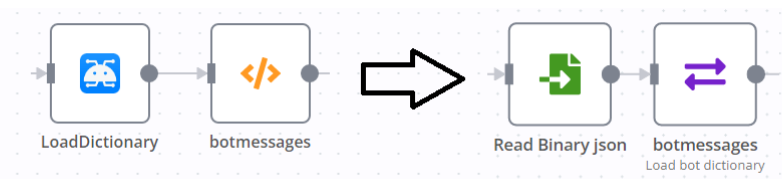

- Loading the whole dictionary from the NocoDB database each time a user sends the Telegram message is not optimal. It increases both the server load and the response time. The bot performance could be improved by storing the bot dictionary on the server in a JSON format. For my own bots I use a separate workflow which is activated every time the dictionary is updated:
- The dictionary is stored on the server as a JSON file and is loaded during the bot initialization phase. Two different nodes are used for that: Read Binary File and Move Binary Data, so the initialization phase should be slightly changed as follows:
