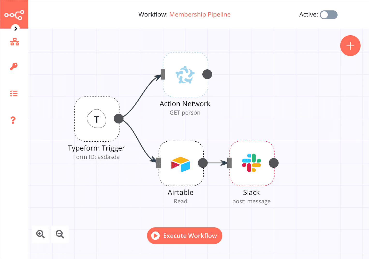

![A diagram from n8n showing Typeform submissions connected to both Action Network and Airtable and then, from Airtable, posting a Slack message.](https://blog.n8n.io/content/images/2021/05/screenshot-n8n-action-network-interface.png)

Considering n8n as an alternative
If you fit into either of the scenarios above, or there’s something else that’s got you burned about Zapier or other subscription tools like it (let us know, we’re curious), then here’s why we think n8n might work for you.
Fair pricing and flexible hosting
- You can self-host it for cheap or free (no fees to n8n) on your choice of Virtual Private Server (VPS), Heroku, your own server or even your personal computer.
- Self-hosting also means you can keep your data private instead of letting Zapier have a free pass at it, which means you could simplify GDPR compliance or avoid surveillance for any politically or personally sensitive organising work.
- They also have a SaaS option which is very competitively priced against Zapier. It’s always cheaper, doesn’t restrict the features that makes an automation/integration tool useful, like logic or multi-step workflows. Crucially, at the top end it’s several hundred pounds cheaper per month, or thousands of pounds cheaper per year.
Configuration and customisation
With Zapier, what you see is what you get. If they haven’t built it, you’re stuck.
- Firstly, if you don’t find the integrations you need, that’s fine: you can send HTTP requests or even write your own JavaScript code inside a workflow to do pretty much anything.
- You can also code your own first-class integrations, or even radically change the system or its UI to better suit your organisation. The code for n8n is available on GitHub and they’re always keen to accept new contributions from the community. We think that’s great!
Reliability and digital sovereignty
Massive campaigns and organisations rely on tooling like Zapier and it’s a real liability!
- n8n, like Zapier, is VC-funded, which is a shame – we’d prefer a co-op or a charitable trust. But it does mean they have a fully funded product team to maintain and improve the system and they have no way of charging you for using their code.
- However you run n8n, you can export and import workflows (the equivalent of a "zap") via JSON. If the cloud version goes down, you can temporarily spin it up on your own machinery and vice versa. Zapier will inevitably fail one day, or they could just decide to arbitrarily block you, perhaps at the whim of the authorities. Good luck trying to work around that.
- It’s worth mentioning that n8n also has some really good features. It has error handling for workflows and even CLI (command line interface) commands for JSON workflow management and backups, if you’re into that kind of thing! We've open sourced our n8n workflows in a backup repository here, which you can pick up and use right now.
- If you are still uncertain, quite a few startups and also some larger orgs like Honest Burger use n8n for their live ops.
Plus it’s really good!
Overall, we reckon that the funded team plus open source combination makes n8n a good candidate for progressive activists to assemble around. The integrations and tooling built for one campaign can be easily reused by another organisation also running n8n. As an example, we recently built an Action Network CRM integration for n8n!
Besides, the tool is actually quite good! You can build fairly complex but understandable workflows. And did we mention the HTTP node?
The visual editor is also nice and comprehensible, and we reckon that with a bit more work on the diagram system it will be able to make your integrations and automations more transparent to your org’s members. These things are organisational business, after all, so anything that builds transparency and accessibility into the machinery is a win for the democracy of your organisation.

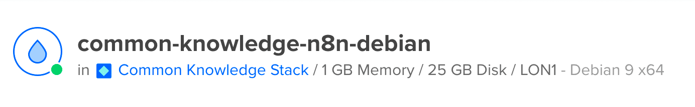

Option 1: Virtual Private Server (VPS) + Docker
We recommend a VPS that isn’t Amazon’s web empire. We are using Digital Ocean, but we’re writing this via Notion which itself relies on AWS, so we’re not exactly heroes.
Overall, n8n has fairly minuscule operating requirements. You won’t need any beefy CPU or RAM, hard drive space or even a database running — n8n will by default set itself up with a file-based SQLite database. Our colleagues at newdesigncongres.org recommend Hetzner running something as cheap as CX11 option (2GB RAM) for only €2.96/month. You could also take a look at Scaleway.
Just remember to pick a UK/EU server for speed and data privacy reasons.
You can simply follow this docker-compose guide to get going in a few minutes.
A quick note that we at Common Knowledge using Digital Ocean / Debian had to edit the image: n8nio/n8n
bit with image: n8nio/n8n:latest-debian
in order to get SSL-enabled email sending to work properly.
![A screenshot of digitalocean.com showing Common Knowledge Co-op's n8n server is running](https://blog.n8n.io/content/images/2021/05/screenshot-n8n-ck.png)
