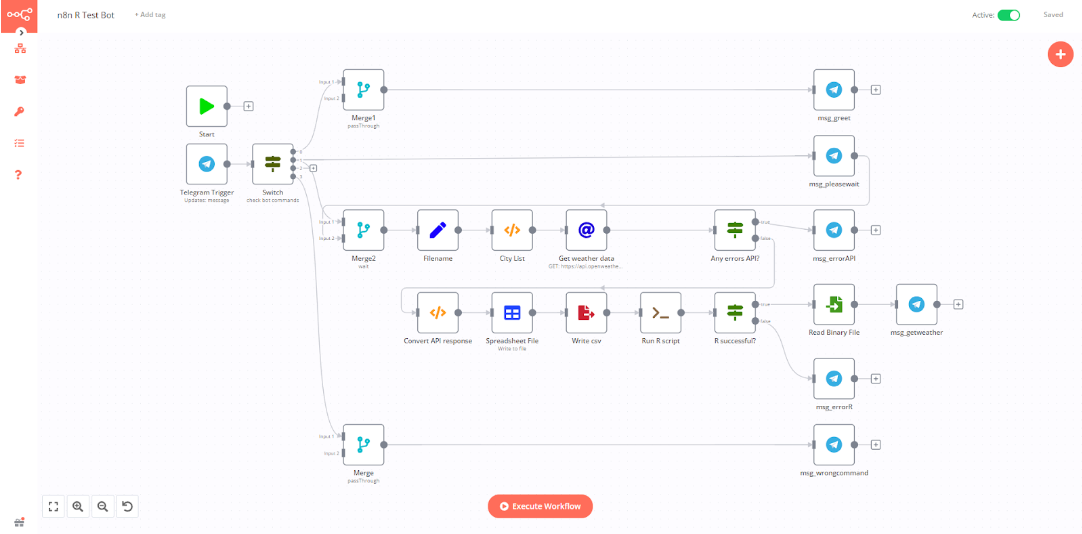

First, we place a Telegram trigger Node to catch the incoming messages. Then, we use a Switch Node to filter the incoming text from the {{$json["message"]["text"]}} variable. In this bot we will process only three cases: /start command will trigger a welcome text, /getweather will do the main functionality and everything else is considered as an invalid command.

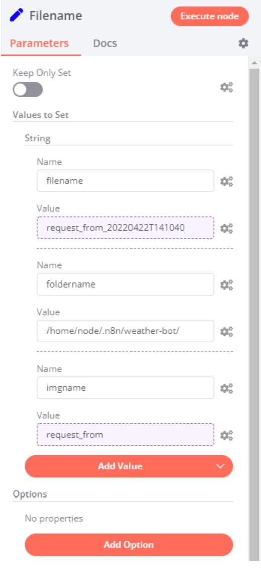

After the /getweather command is submitted we will first set up a few variables using the Set Node.
  • filename is an expression which concatenates Telegram ID and a timestamp, and will be used to save the csv file and log.
  • Foldername depends on your VPS setup.
  • Imgname is the filename of the outcome image. It only defines a Telegram user ID, because we don’t want to store all the images that were sent to the user.
Set node configuration

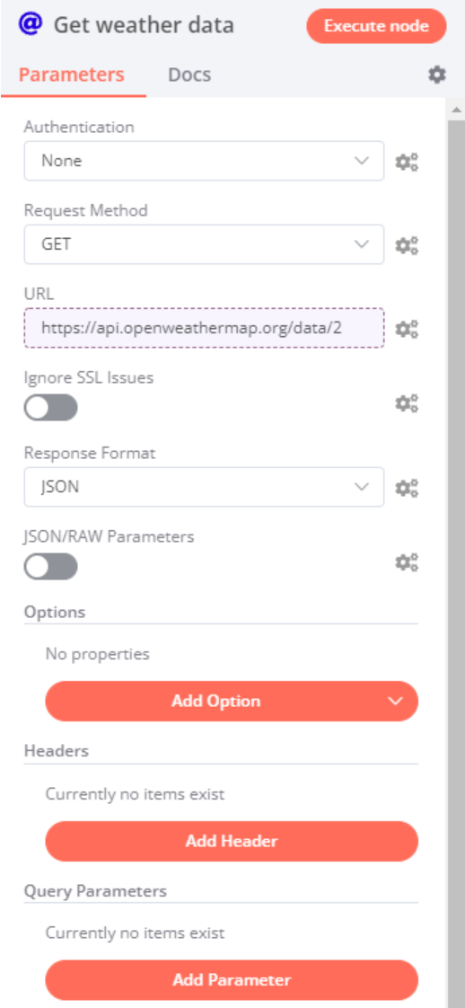

Since n8n does not have a special Node for the OpenWeather service, we use the HTTP Request Node.
HTTP Request node configuration

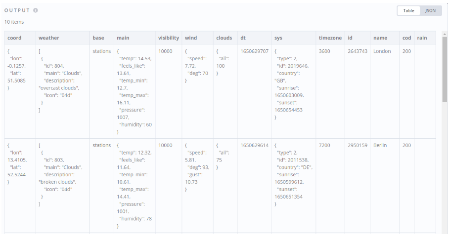

This call will trigger ten API requests (because we have configured ten cities) and the result will look like this:
HTTP Request output
HTTP Request output

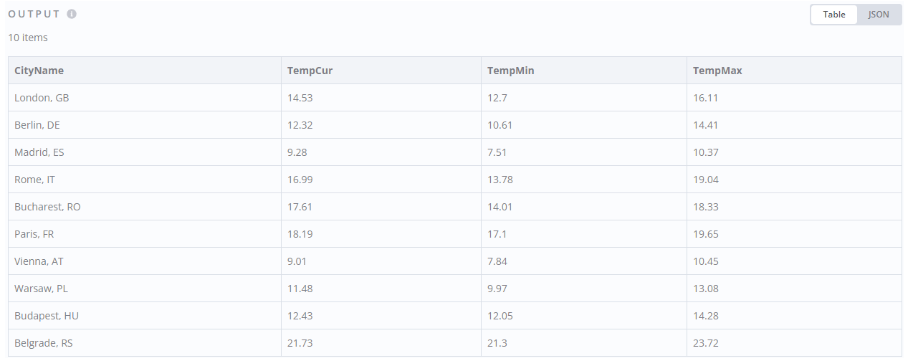

The result is a nested JSON file. To make it more readable and get the data we need, we have to process the JSON output using JavaScript in the Function Node, so the data looks like this:
Output view
Output view
Now we can save the table in CSV format and put the file on the server.

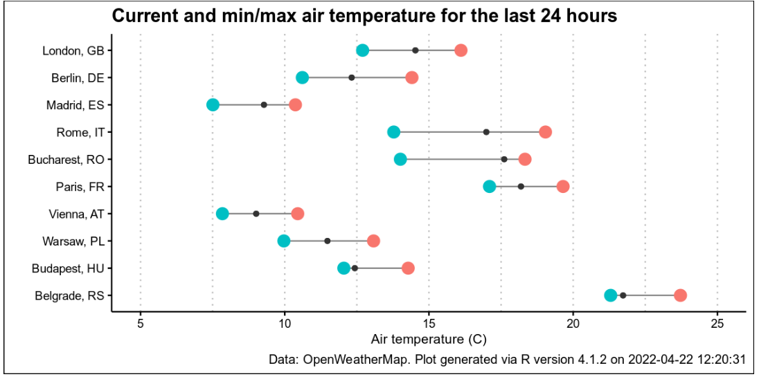

After this is completed we can run an R script that will create an image. For this we need to run an Execute Command Node. The command option is also an expression:
Rscript --vanilla '{{$node["Filename"].json["foldername"]}}dumbbell_plot.R' '{{$node["Filename"].json["foldername"]}}{{$node["Filename"].json["filename"]}}.csv' '{{$node["Filename"].json["foldername"]}}{{$node["Filename"].json["imgname"]}}.png' >& {{$node["Filename"].json["foldername"]}}{{$node["Filename"].json["filename"]}}.log
Here we call an R script called dumbbell_plot.R and pass two parameters: path to a csv file and an output name. After that we also create a log file. The R script can be found here.
Running the R script generates the following image:

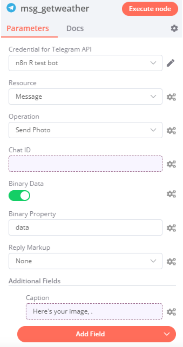

Now we can send the image in a Telegram channel using the Telegram Node.
Telegram node configuration
Finally, executing the workflow will run all the nodes and if everything is configured properly, you should get a message from your Telegram bot with the weather plot.
You can test the bot I built here.
